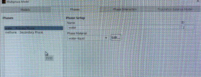

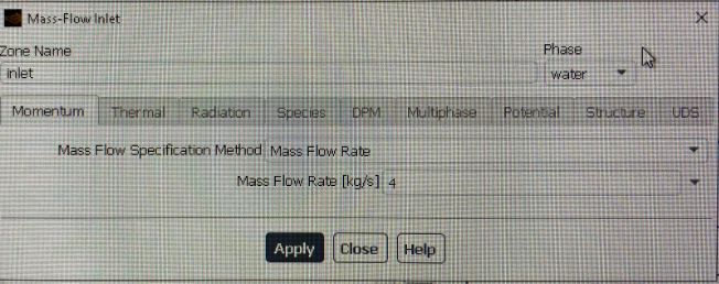

SubscriberHello everyone. I'm working on a water + gas VOF problem.

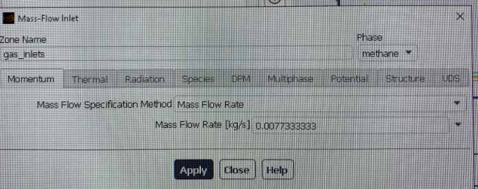

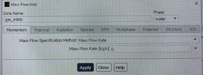

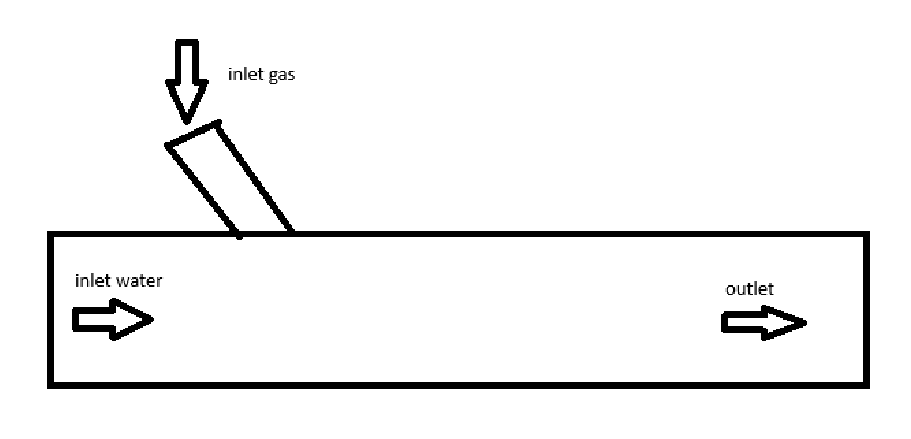

I set the water density to 700 so it resembles oil. I'm using methane as the gas.I'm using a simple flow chart:

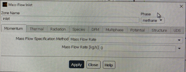

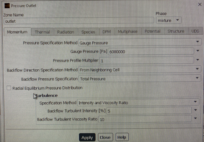

My system's total water flow rate is 500 m³/day, gas flow rate is 1000 m³/day, and the outlet pressure is 6 MPa.
I converted everything to a mass flow rate of kg/sec, and the result is 4 kg/sec for water and 0.00773 kg/sec for gas at the inlet.But when calculating, I get a FLOATING POINT EXEPTION error. Why? I entered everything correctly.

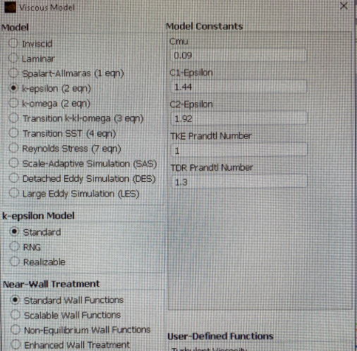

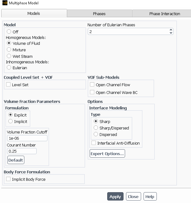

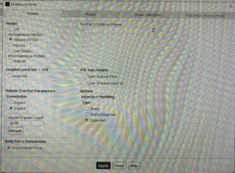

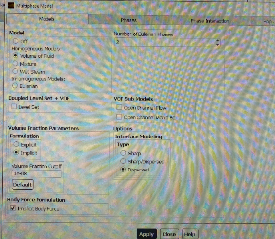

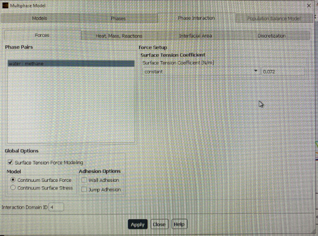

Below are my calculation settings. Please take a look at where I made a mistake. -
November 26, 2025 at 9:55 am
Rob
Forum ModeratorIt's diverged, so start with the mesh and work on from there. Why are you running VOF with a dispersed interface: that's really not a good combination.Â

javat33489
SubscriberSir, the grid is fine.

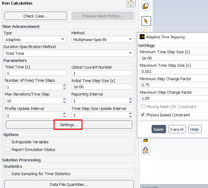

If I don't enable the VOF model and run the system on water or gas only, everything works fine. But as soon as I enable the VOF and phases, I get an error.
Sir, I also tried SHARP, but it doesn't help.
November 27, 2025 at 9:15 am
Rob
Forum ModeratorAnd the time step size? Given the potential speed difference which flow regime are you working in? And I don't mean laminar/turbulent.Â
