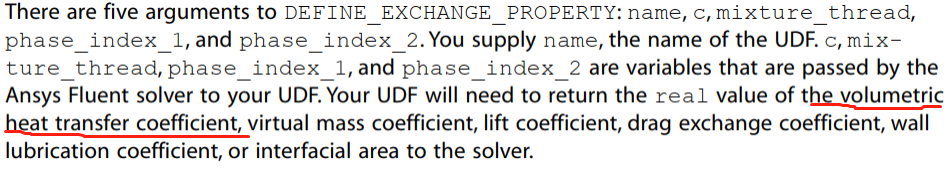

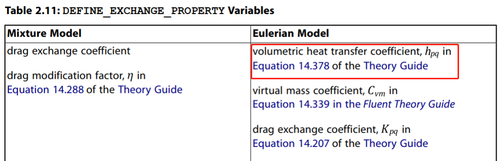

Let me confirm once again that the User-Defined Function (UDF) needs to provide the actual volumetric heat transfer coefficient in units of W/m²*K. This coefficient should be calculated using the properties of the gas to define the Prandtl number.
This information is mentioned in both the theoretical manual and the UDF manual. However, I've noticed a discrepancy between this information and the heat transfer coefficient UDF example provided in the UDF manual. So, I would like to verify this once again for clarity.

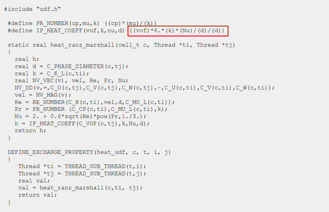

In the example 2.4.3.5 provided in the UDF manual, the returned heat transfer coefficient is multiplied by the interface area density. However, according to the definitions and descriptions given earlier, the expected return value should be the true, unmodified heat transfer coefficient. Does this mean that there is an error in the provided example? Below is a screenshot of the code from the example.

Please check my earlier post for clarification. It says that "The UDF will need to return the real value of the effective heat transfer coefficient to the solver. So, if the quantity being modeled by your UDF depends on the interfacial area, your UDF should return the coefficient multiplied by the interfacial area."
This is why in the example, the returned value is multiplied by the interface area.

This means that in the UDF definition for the phase interaction of heat transfer coefficient, what I need to return is the effective heat transfer coefficient, which is the product of the volumetric heat transfer coefficient and the interface area. Instead of the Single volumetric heat transfer coefficient introduced and mentioned in the manual earlier, right?
