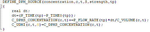

      Can any researcher provide the udf for calculating the particle concentration in FLUENT DPM model using "PSI-C" method?
      I tried to write this udf, but after using both "DEFINE_DPM_SCALAR_UPDATE( ParticleCon,c,t,initialize,tp)" and "C_UDMI(c,t,0)+=P_FLOW_RATE(tp)*dt/C_VOLUME(c,t)" at the same time, the residence time of particles within a cell is always cumulative over all iteration time steps and is not only the final value. Besides, the concentration is always cumulative over the flow time steps.Any suggestion or comment is welcome!
      (the residence time dt= (P_TIME(tp)-P_TIME0(tp)))

    • xsp2020
      Hi sdeb
      Thanks for you answer. As a new to UDF, I tried the idea of particle loop based on the Fluent Customization Manual's example 2.5.12.3, the udf tested is shown below. Surprisingly, the contour output of UDM results is always 0. Could you please provide more information about your idea?
      Then, besed on my tests of comparison between "C_UDMI(c,t,0)+=C_VOLUME(c,t)"and"C_UDMI(c,t,0)=C_VOLUME(c,t)" in the "DEFINE_DPM_SCALAR_UPDATE( ParticleCon,c,t,initialize,tp)", the "C_UDMI(c,t,0)+=..." can successfully tracking the particles in every cell and display the gradient-changing contour,in which the inlet position is highest because more particles passed with the same cell volume. Hovever, it still exists the cumulative issues described in question. Due to the "0" resul of the particle loop method, i still couldn't try more parctices to validate its effectiveness.

    • Amine Ben Hadj Ali
      Examples are provided in the Customization Manual.
      With DEFINE_DPM_SOURCE you can easily calculate Residence time as you have State at Entry and State at Exit from the cell. From that you get the the time and you can do with it whatever you want like averaging, etc. Once you have done that it is time to store into a cell memory and here I recommend that you track particles using MPI and not Hybrid to avoid issues related to competing tasks (One can avoid these issues but that will require some further coding).
    • xsp2020
      HiDrAmine
      After several attempts with the udf shown bellow, result cannot be obtained correctly due to unclear matters in the code. Could you please take another look at it for me? Thank you for your help with your previous reply.
      Your UDF is wrong: C_DPMS_CONCENTRATION is actually the DPM Concentration you want to access which is already available. It is provided by Fluent: so no need to overwrite it.
