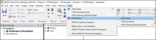

      Hi,nMake sure that n1) the port is exterior to the coplanar waveguide structure and is in contact with the structure,n2) width of the port should not exceed the vias placed along the length of wave guide,n3) height of the port satisfies the criterion of Wave port size as defined in the HFSS help document. You can access the help document as shown in the image belownAll the best.nBest Regards,n
