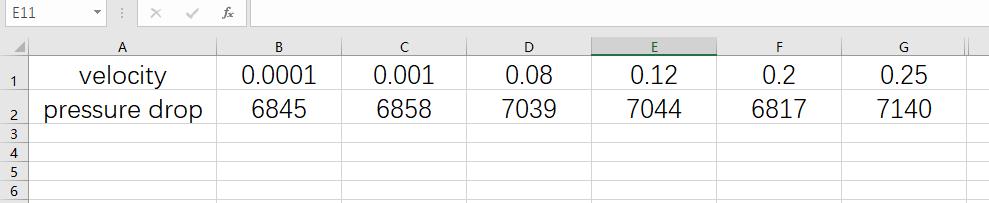

      I have been doing the tutorials, called for Modeling Uniform Fluidization in 2D Fluidized Bed.
      I did this at the beginning and it gives me a constant value equal to the bed's weight (no matter the velocity).
      I just wondering if anyone had met the same problem, and what was the way to solve it? Please feel free to reach me via

    • DrAmine
      You need to be much more precise in your communicaiton: what is the constant value? Are you talking about pressure drop? Perhaps you reached the minimum fluidization velocity?
      The key feature in capturing bed height and pressure correctly is the spatial and temporal resolution of the simulations. Specifically, for spatial resolution, mesh size should be smaller than 10*dp (particle diameter) (delatx<10dp)
    • Armand
      Even if the gas inlet speed is zero, the bed pressure drop is equal to the weight of the bed material.
      Best regards,
      Armand

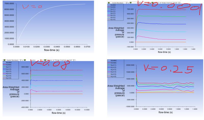

    • Armand
      In my project, the spatial resolution is what you say.

    • DrAmine
      Perhaps reporting issue otherwise you won't get different profiles: remove the bed density from pressure via custom field function. I cannot now check what we have done years ago to get to get the well known curve.
    • DrAmine
      How are u reporting pressure?

    • DrAmine
      Stop referring to old posts (my posts) and respond to the comments. For sure the walls have a sustaining effect and you need required resolurion but you can check if the hydro head is spoiling pressure field. We obtained good result for drop curve.
    • Armand
      I reported the pressure drop by monitoring the total pressure of the air and the static pressure of the mixture.
      Best regards,
       Armand
    • Armand
      How can I check  if the hydro head is spoiling pressure field?

    • DrAmine
      I looked back to my tutorial: I am just evaluating the static pressure  @inlet and @outlet (set as outflow). In the tutorial the min. fluid. velocity is about 8 cm/s. I will update later once again.

    • DrAmine
      So I run basically three points far below the expected 8 cm/s
    • DrAmine
      and I definitely can confirm that the pressure difference is increasing.

    • DrAmine
      1 meter height 0.15 m bed width. I used wen drag and enabled Schaeffer friction and frictional pressure after Johnson. Time step size 0.0001 s. One has to be patient to reach steady state pressure level.

    • DrAmine
      Best to monitor pressure differences between in and out. Create two reports based on area average of pressure than a third one for difference and monitor that.
