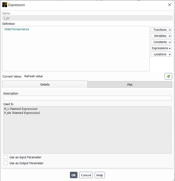

SubscriberDEFINE_SOURCE(elec_power,c,t,ds,eqn){real x[3];real ir;real source;C_CENTROID(x,c,t);ir=1.687E+06+31657*x[0]+62239*x[1]-4.902E+08*x[0]*x[0]-1.869E+06*x[0]*x[1]-4.944E+08*x[1]*x[1]+1.008E+06*x[0]*x[0]*x[0]+1.698E+07*x[0]*x[0]*x[1]+6.09E+06*x[0]*x[1]*x[1]-3.391E+07*x[1]*x[1]*x[1]+8.459E+09*x[0]*x[0]*x[0]*x[0]+4.648E+08*x[0]*x[0]*x[0]*x[1]+1.584E+11*x[0]*x[0]*x[1]*x[1]+1.243E+08*x[0]*x[1]*x[1]*x[1]+9.672E+09*x[1]*x[1]*x[1]*x[1];source=-(0.0144*0.55894609*ir*(((0.21+((-0.002)*(C_T(c,t)-298.15)))*(1+((((2.62323E-23)*(C_T(c,t)))/((1.602176E-19)*(0.93040049+((-0.002)*(C_T(c,t)-298.15)))))*((double)log((double)833)))))-(((0.0263+(0.0000355*833)+(0.00178*(C_T(c,t)-298)))*833*833*(pow((0.009637761+((-0.0007)*(C_T(c,t)-298.15))),2.))))))/0.00000864;C_UDMI(c,t,0)=source;return source;}this is my udf which i have a problem in ansysÂso i want to make the same thing in named expressionso i had a problem in defining the cell temperature at centriod in named expression like udf

Subscriberis that what you mean?

Subscriberso when i use the same thing in the picture in the equation
it will be read as cell temperature at cetriod for the part i want or not
this is the question

Ansys EmployeeYes that variable corresponds to the cell centroid static temperature. -
March 16, 2023 at 3:34 pm
Amine Ben Hadj Ali
Ansys EmployeeAs you are not liniarzing you can directly provide the source term via Fluent Expressions. Please check your region you are trying to emit the source if it is correct.

Ansys EmployeeI refer here to the Customization Manual where DEFINE_SOURCE is explained.
Another good reference is to go through the basics with reading the simple introduction of Patankar "Numerical Heat Transfer and Fluid Flow".
Linearization will help on stability.
