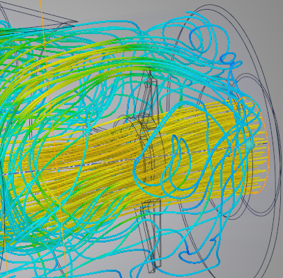

      For this analysis, I've used an assembly in SolidWoks, exported as .STEP214, .ACIS and .IGES. However, in all of them, the air flow does not consider the other bodys in the original assembly, just the external case. What can I do to make all the parts of the assembly recognizable in the simulation of the Ansys Discovery live 2020R2?

      Will it be possible to send the files so that I can look into them? I have sent you the secure transfer link.

      Sorry for the delayed response Igor Ribeiro
      I have sent the files to the developers, I tried testing the files you shared, and I agree it is not being considered in the simulation. I will get back to you.
      Regards.
    • Charudatta Bandgar
      I have filed a bug ticket (412549) to understand better.
