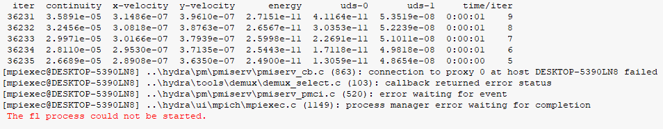

      I am trying to run a 3-D flow simulation over a wing. A couple days back, I ran the simulation with no problems. I have refined my mesh a bit and reduced the computational domain just to check grid independence of the results but no FLUENT kicks out every time I try to run my calculations. I have included a screen shot of the message I get. Any help would be greatly appreciated. Thank you

      Since you mention that your simulation ran earlier with no issues, and now after refining the mesh it shows up this error, I think it would be because of the number of nodes in your mesh. Can you provide some numbers? No. of nodes (before refining and after refining), RAM specs?
    • oyallou
      That would make sense. I believe before refining the mesh, the number of nodes were under 500k. Now, the number of nodes reaches nearly 2 million.
      The RAM on the computer is 3.49 GB available.
    • raul.raghav
      Quick question: How much is the total RAM in the computer?
    • oyallou
      There is 4 GB of RAM installed.
    • raul.raghav
      oyallou, that would be a problem. I doubt if your computer will be able to handle those many nodes. I believe 1 to 1.2 million should work fine with 4gb RAM. But you've got to use another computer with more RAM or upgrade your RAM to handle more refined meshes (more than 1.5M nodes). Good luck !
