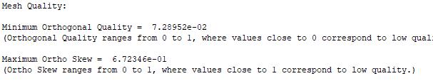

      2-good mesh= see attached.

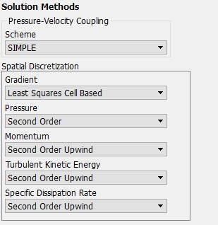

      schema of solving

      Ortho quality is  not really good: I hope only few cells are bad.
      Regarding the time interval: I assume you stopped the run and then you started again. That might explain why it runs over the 0.2 s
