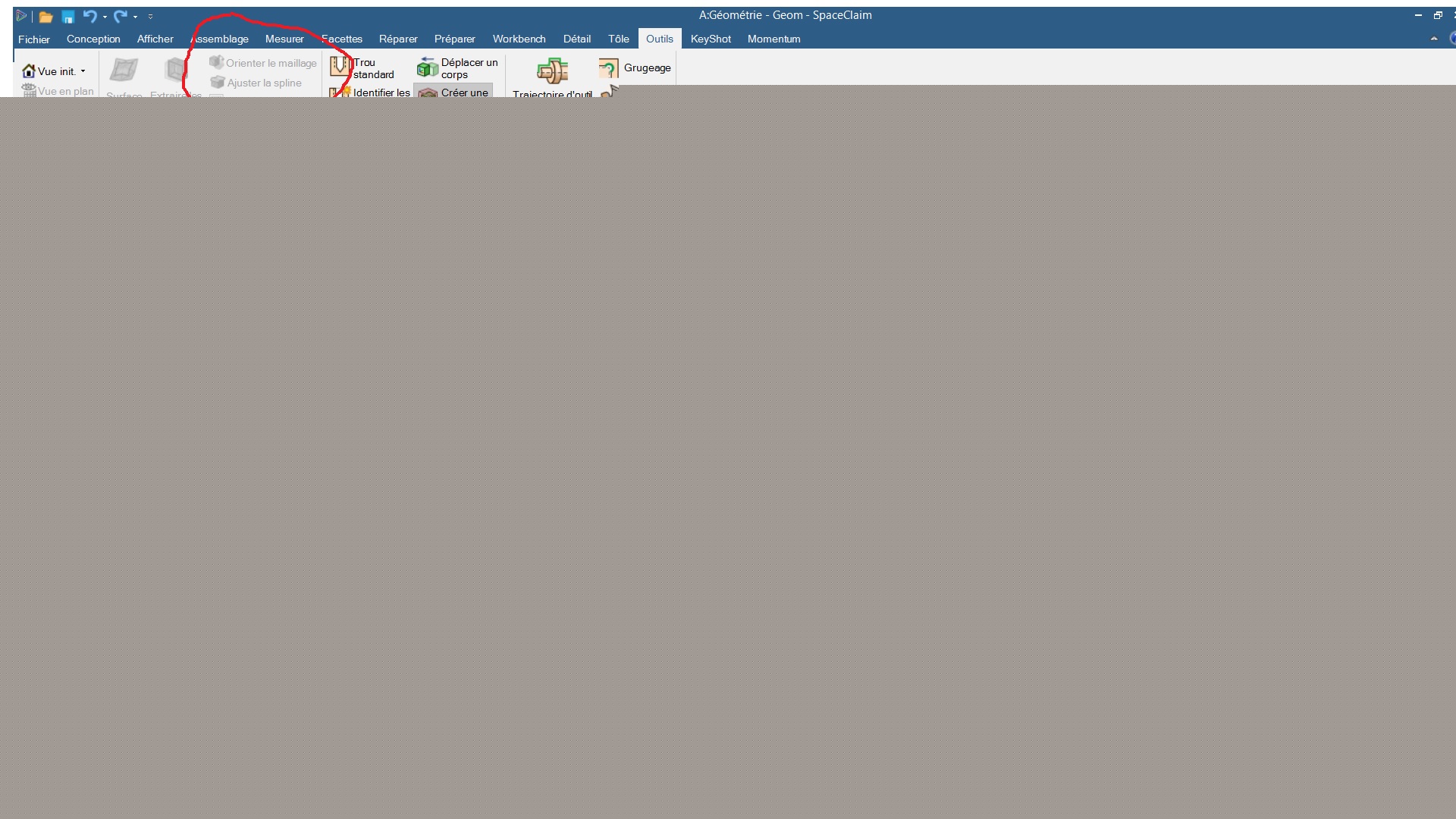

mehdiyahia1
SubscriberI can import, but I can't manipulate.
October 16, 2019 at 3:36 pm
mehdiyahia1
SubscriberI have this comment: the mesh size is not impermeable.

peteroznewman
SubscriberYou can right mouse click on the Facet body and Convert to Solid, then it will be available to edit and mesh.
October 17, 2019 at 1:07 pm
mehdiyahia1
SubscriberPeterosnewman thank you for your answer
For the conversion to solid it is done. but not to be able to edit .
October 17, 2019 at 2:52 pm
peteroznewman
SubscriberWhat edit do you want to do?
There are some tools to clean up the facet body before conversion to solid.
Once the facet body has been cleaned up, the solid body should be able to be split with a plane for example.

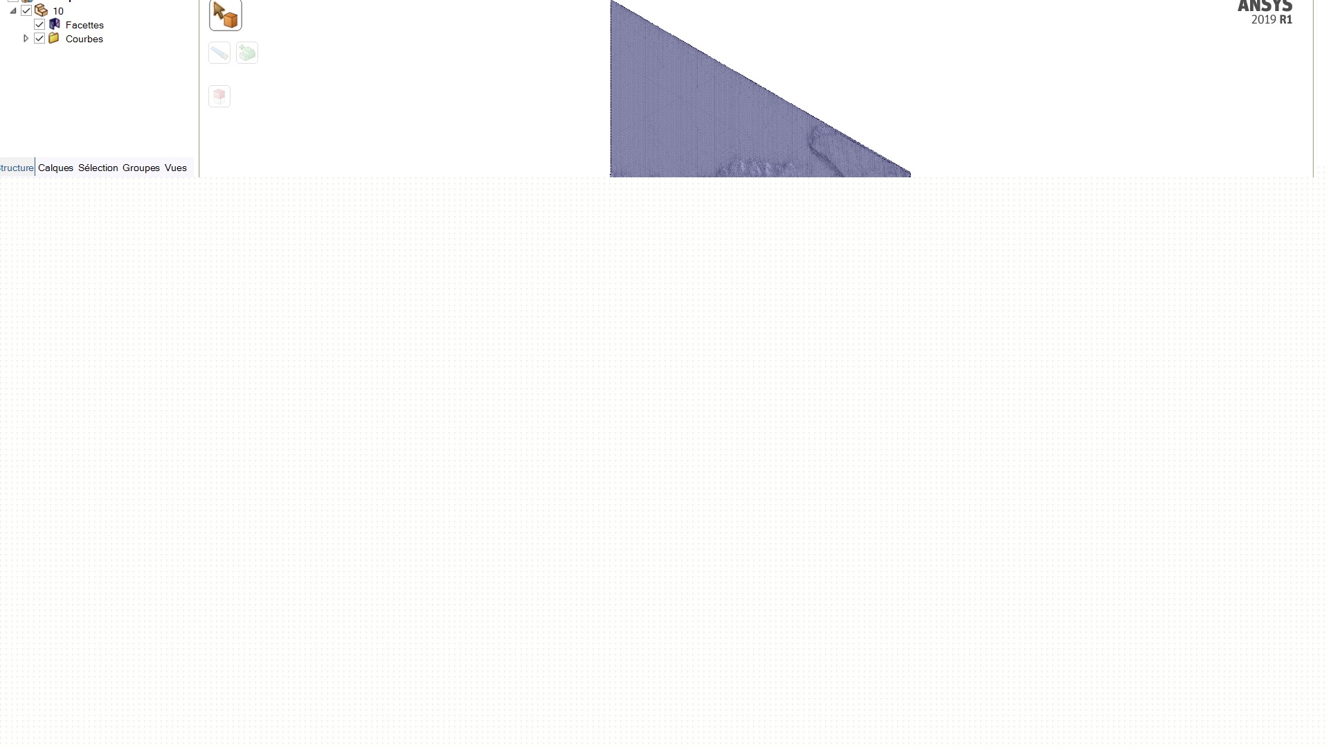

mehdiyahia1
SubscriberI need the terrain as a solid , and above this terrain the air as shown in the picture.
October 18, 2019 at 3:25 am
peteroznewman
SubscriberI see you are using ANSYS 2019 R1.
When reading STL files, it is easy the get the units wrong. What are the units in the STL file?
If they are mm, then the area is about 11.1 x 9.5 meters. Is that correct? That is what is in your SpaceClaim doc.
October 18, 2019 at 5:26 am
mehdiyahia1
SubscriberThe unit is Km 11.1 km*9.5km

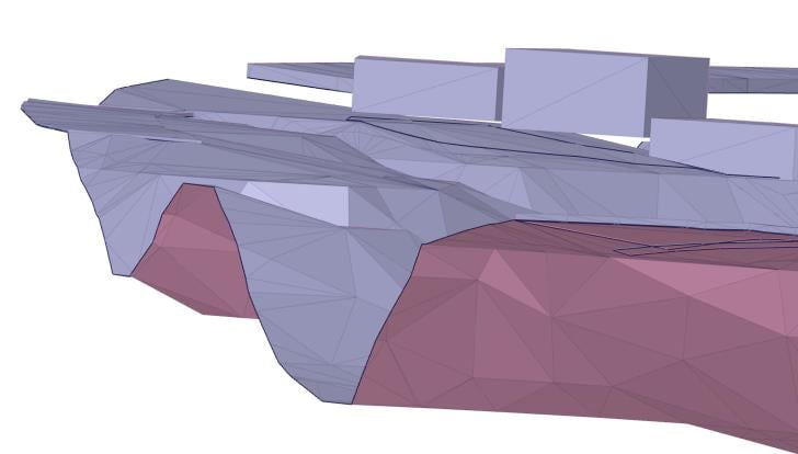

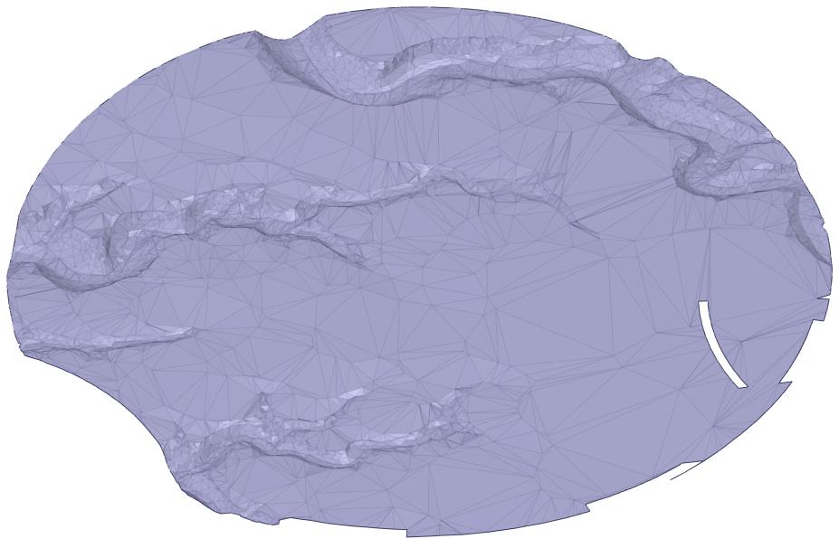

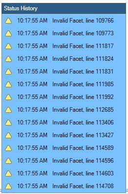

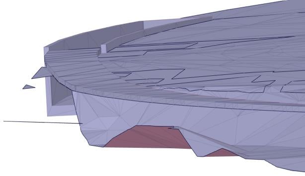

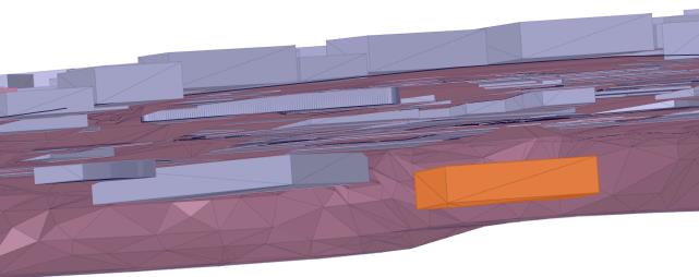

peteroznewman
SubscriberHello Rajasekhar,
Your STL is not clean like Mena's was. Here is the report on import into SC 2019 R3.
It has a mixture of closed facet bodies and open facet bodies and some hanging facets.
You have buildings floating above the ground.
Other blocks are completely below ground.
If you Separate All on the Facets tab, there is one facet that seems to be just Ground.
You have to clean up the data before you can create air or earth. What is your goal, just air or both?
What version of ANSYS are you using?
Please start a New Discussion as this is already too long. You can insert a link to this post.
