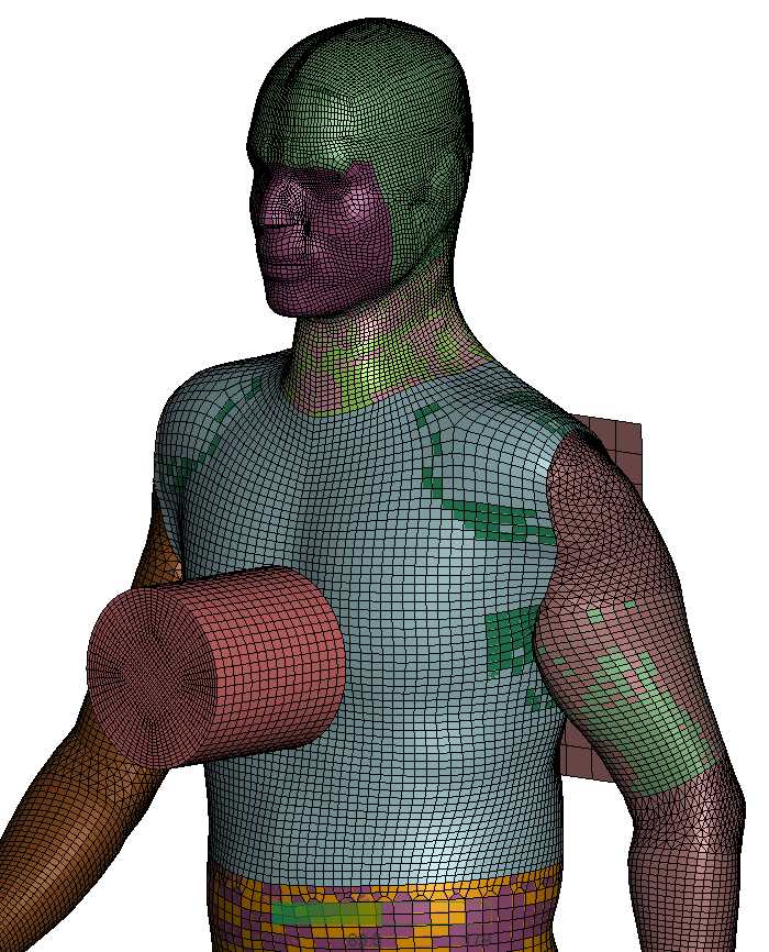

      I am trying to simulate crash impact conditions using GHBMC-50 Model, I have included the impact condition as seprate file. when I do included my boundary contion and run the simulation , I am getting an error messege, "the termination due to out-of-range forces and moment number of nodes having out-of-range". Please any advise to overcome this problem will be really appriciated
      I am looking forward to hearning from you soon
      Best Regards
      Hamid

      Here are some general tips for how to combat instabilities:
      https://www.dynasupport.com/faq/general/have-you-any-tips-on-how-to-to-combat-instability
      https://www.dynasupport.com/howtos/element/negative-volumes-in-brick-elements
