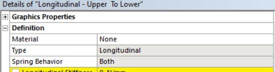

I am using ANSYS Workbench 18.2 and I'm trying to define linear longitudinal tension-only spring connections in a 2D (plane strain) model. The spring behavior was automatically set to "Both" and this section is grayed (as shown in the below screenshot) and I can't change it. Could you please let me know if there is a way to change my springs behavior from "Both" to "Tension only"?

Diane
SubscriberHi Wenlong,
This solved the issue, thank you very much!
