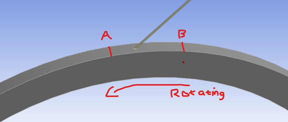

      Hello
      I am simulating a heat generation by friction between 2 bodies. The upper body is stationary and lower body is rotating. I would like to ask is it possible to transfer the data (temperature) on line A as an input to line B continuously in the simulation? If it is possible how to do that?
      Thanks a lot
    • Subodh Adake
      I am assuming, you want the temperature on line A to be equal to line B. If thats the case, you can try define a TEMP DOF coupling between these two lines.
      Subodh.
