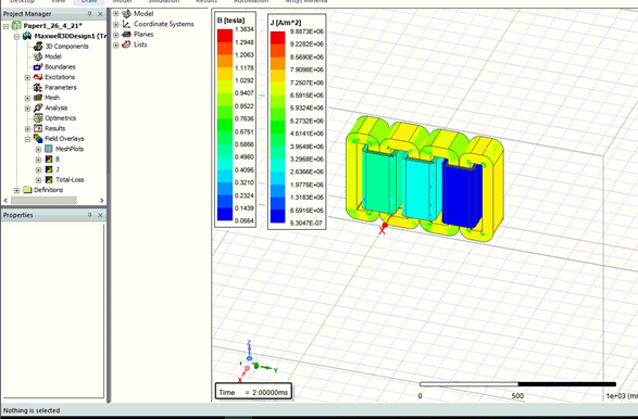

      I have simulated High Frequency Transformer (HFT) in Ansys Maxwell 3D transient analysis. The corresponding simulation details are given below:

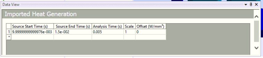

      Thankyou for your reply. Your explanation is clear to me. I have reset the atmospheric temperature as 40degrees. I have given that as initial temperature in in ansys also. Imported load scaling factor is nearer to unity as shown below.
      I have one more doubt. here I imported heat generation from 0.01sec to 0.015 sec done in maxwell. Analysis time is predefined as 1 sec (not able to edit for me).
      Thank you once again for the reply. I will go through your suggestions.
      If possiible consider above cases also
