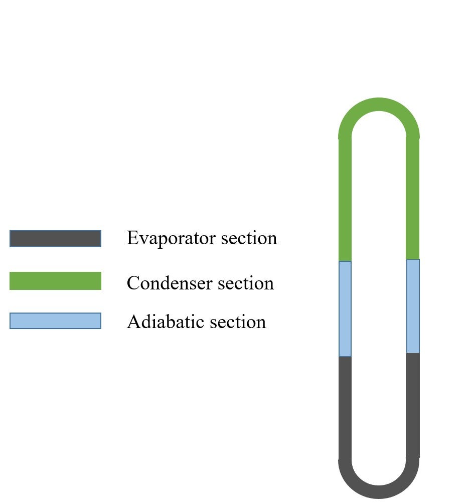

      hello,
      I am working with 2-D transient simulation with compressible flow, gravity assisted.
      I am using VOF- multiphase model and evaporation condensation model as the phase change model, with saturation temperature as a function of saturation pressure.
      Liquid is primary phase and Vapor is secondary phase.
      liquid properties - piece-wise polynomial function of temperature
      vapor density - Ideal gas
      vapor viscosity and thermal conductivity - piece-wise poly function of temperature.
      Operating pressure - (Floating) 0 Pa, gauge pressure - 76043 Pa
      Operating density - 0 kg/m3
      Initial temp - 75K
      CONVERGANCE criteria -
      (continuity - 1e-05), (velocity - 1e-04) and (energy - 1e-06)
      SOLUTION METHODS
      Pressure-velocity coupling - SIMPLE
      Gradient - Least squares cell based
      Pressure - PRESTO
      Density - second order upwind
      Momentum - Quick
      Volume fraction - Conpressive
      Energy - first order upwind
      All the URFs are default.
      The temperature of the evaporator section is increasing. I do not understand why..
       Any help will be highly appreciated.
      What are the boundary conditions?
    • abhnv11295
      So, basically I have three sections of the PHP.
      BCs are Thermal wall boundary conditions
      Evaporator section - Constant heat flux
      Condenser section - Constant temperature
      Adiabatic section - Zero heat flux
      Evaporator section will increase in temperature because the wall MUST push in the defined heat flux. So, that wall will heat up to infinity if you don't extract sufficient energy from the condensor section.
    • abhnv11295
      Rightly said Rob.
      Thanks for the reply.
      The boundary conditions are set according to experimental values.
      Regarding the sufficient energy generated on the condensor section, I have two queries as following:
      Say, if I am not being able to get sufficient cold from the condenser section, will it be the right way to decrease the condensor temperature to get enough cold?
      Or is there any way to check whether enough cold is generated on the condensor side or not?
      That depends on what you want to adjust: I can only advise on what the solver is doing, not what boundary values you ought to pick.
      I also assume that the mesh is sufficiently well refined to pick up the wall & free surface boiling & flow.
    • abhnv11295
      Yes, my mesh is well refined.
