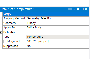

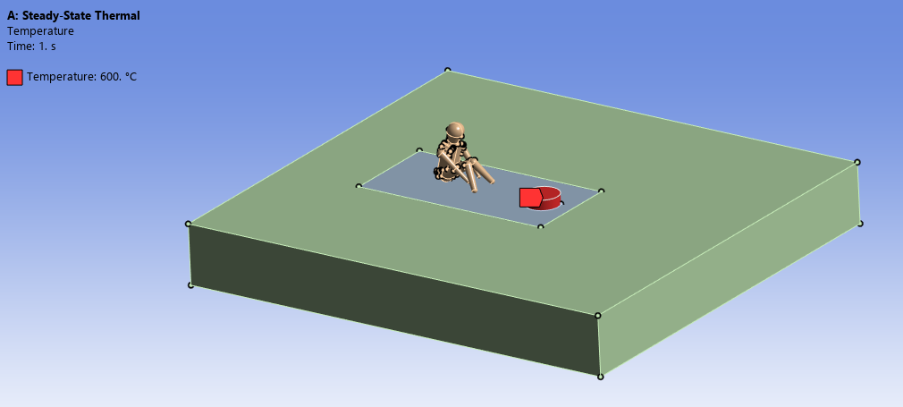

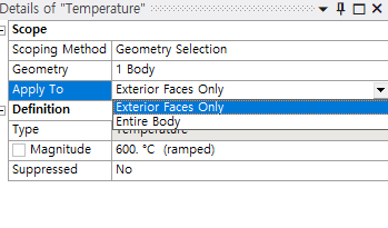

In Ansys Steady-State Thermal analysis, when a Temperature boundary condition is applied at the body level, the ‘Apply to’ option provides two choices: ‘Exterior Faces Only’ and ‘Entire Body’.
When selecting ‘Exterior Faces Only’, I would like to understand which faces of the body the temperature is actually applied to.

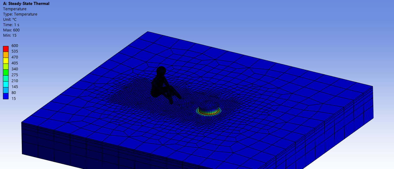

Additionally, in my current analysis, when I applied a convection boundary condition to some surfaces of a body that was set with ‘Exterior Faces Only’, those surfaces did not maintain the prescribed temperature.
In this regard, I would like to know whether there is any internal priority or handling mechanism between boundary conditions in Ansys.
Exterior Faces Only Result
Entire Body Result

Ansys EmployeeHello,
If you assign a convection boundary condition to a specific face and also have a temperature condition set with ‘Exterior Faces Only’, the face-specific condition (convection) will take precedence on that face. The temperature condition will only apply to exterior faces that do not have another, higher-priority condition directly assigned.
This means that if you see a face with convection not maintaining the prescribed temperature, it is because the convection condition is taking effect on that face. For more details, refer to the Ansys Mechanical documentation on resolving thermal boundary condition conflicts:
17.8. Resolving Thermal Boundary Condition Conflicts-
