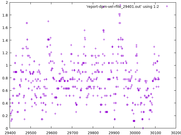

      2. I have seeing some repeating patterns but the difference is sometimes quite large to say that it is converging at some value. I have attached the convergence result for dpm velocity mag (y axis) vs iteration(x axis) for unsteady solver. Is this converging or do I need to continue further?
      The time averaged data is for scalar fields, and is as you think. You can plot RMS-particle-x-velocity but not the RMS-particle-vector. It's likely Fluent only unless you add those CFFs/RMS fields to the .cdat file.
      If the model is transient then iteration number is meaningless, if it's steady state then the particle update frequency may play a part in the convergence. Given the plot is also not an averaged value it's difficult to read.

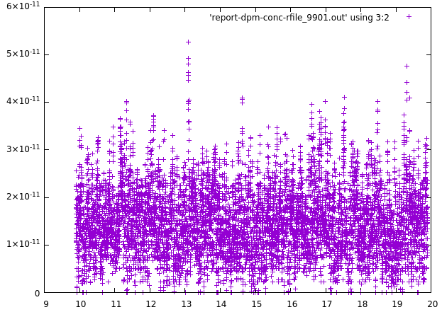

      Hi-I have attached a new result which gives dpm concentration(y axis) vs time (x axis) at a given point in the domain. Is the convergence looking okay? By average do you mean taking time average over specific perioid of time and then plot with time? like 2-5s, 5-8s, 8-11s, and then plot it?
      Each point being at a different time step?
    • scabo
      This result is at a given point in pipe. Yes each point on the graph is at different time-step or flow time. I have given the time-step=0.001 for flow and 0.0001 for particles. Is this procedure correct for monitoring flow convergence?

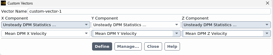

      Hi-What i have found out is: When i do unsteady statistics, the mean/time-averaged DPM x,y,z velocities are available. So, i created a custom vector with those 3 variables as 3 components of the custom vector. It gives the time averaged DPM vector field. Is that right? Custom field function is not required for this.
      And even if i write>particle history data in CFDPost .cdat format I cannot draw the vectors of dpm particle in CFDPost. I think this is a compatibility issue and only doable in Fluent. Also CFDPost is not taking userdefined variables while creating vectors.
      The particle tracks can be coloured by particle velocity. Please post a screen shot of your custom vector definition.
      CFD Post may not know about the custom options as it's a Fluent function.
    • scabo
      Hi, here is the screenshot. Is it okay? It seems Fluent is the only option for post-processing DPM.
      That should be fine. Note, it's the DPM result on the cell, so if there are two parcels going in different directions (or speeds) you'll get the cell average.

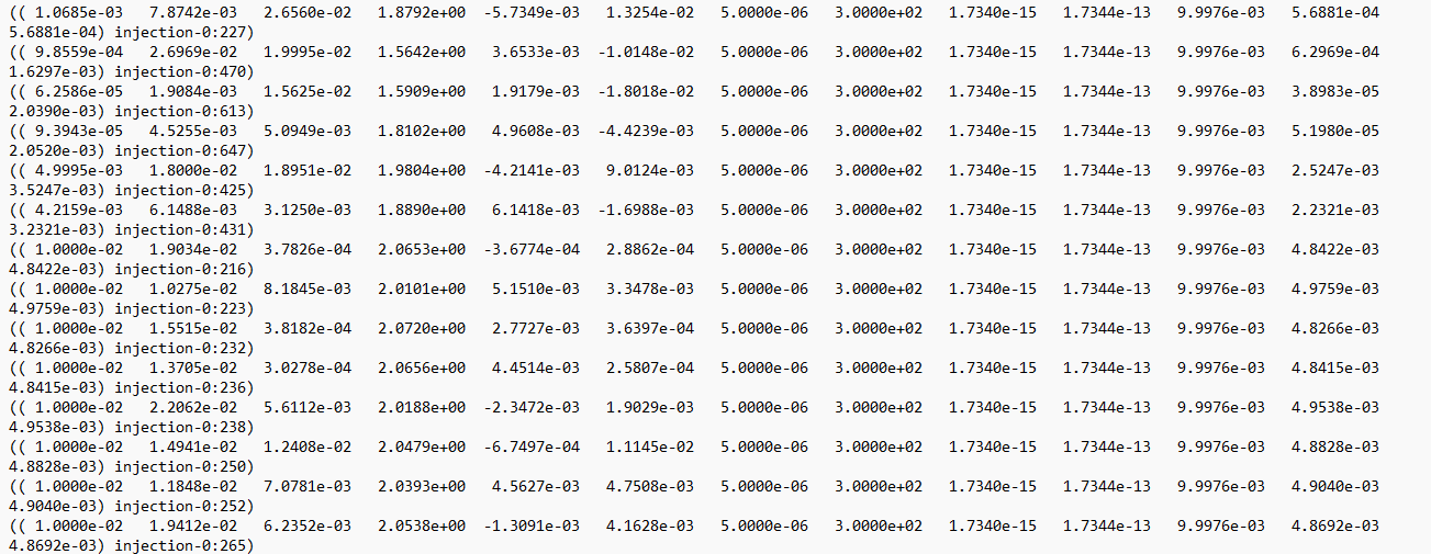

      Hi-I selected interior fluid as boundary and no surfaces because i wanted the positions in the 3D fluid domain inside the pipe. Now it has written some files called interior-fluid.dpm.1, interior-fluid.dpm.2, and  so on. Are these particle properties on different nodes? But how will i understand the particle id? I want to draw the trajectory of a single particle over time. I have attached the file it has written in the working dir.
      How many zones did you pick when you set up the report? I don't recall seeing any parallel effects when I've used DPM Summary but also don't tend to report on the fluid interior. The name shows the injection that released the parcel and it's ID. As long as the parcel count is sensible and parcels aren't colliding you should be able to find the data for a single parcel as it's tracked through time. Python or similar may help, otherwise you've got something to keep you busy with over Christmas.
    • scabo
      Hi-I did /report/dpm-sample injection-0 interioir-fluid () () no. This TUI command to sample properties on the actual 3D flow. I did not choose any surface. I only selected 1 zone that is the fluid. You are saying that injection-0:227-here 227 is the parcel no? ALso it is writing several of such files (attached). SO it is a bit confusing.
      How many times are you running that command? Ie is it an Execute Command? And, yes, 227 should be the parcel ID.
