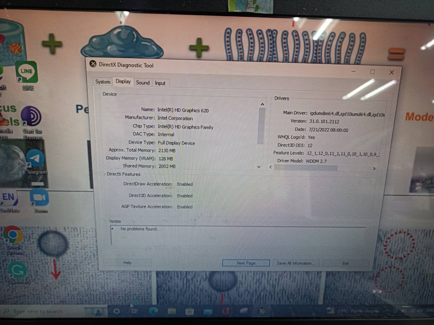

      I want to know if my graphic card is sufficient to run Ansys.
