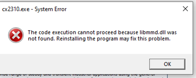

I've recently encountered some problems. When I try to open Fluent Watertight Geometry Workflow from SpaceClaim, I get the following error message:

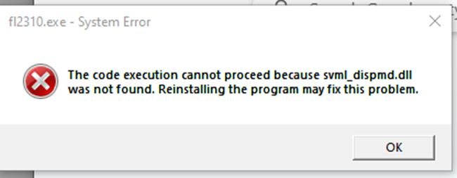

In addition, when I try to launch Fluent, I get this:Â
How do I go about in solving these errors? I've tried reinstalling the program as suggested without any success. The libmmd.dll doesn't exist in C:Windowssystem32

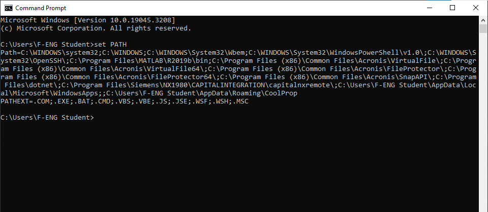

Ansys EmployeeWhat is the output from opening a dos command promtp and typing in:
set PATH-

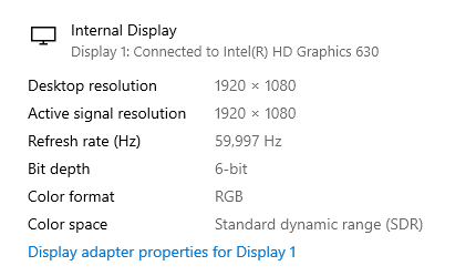

is a professional graphics card installed and does it have a recent graphics card driver manually downloaded from manufacturer website and installed on the system ?Â

Ansys EmployeeAre you able to launch fluent outside of workbench (from Fluent Launcher)
August 1, 2023 at 9:15 pm
Thabang Mathibe
SubscriberNo, I'm not able. The error "cx2310.exe" shown on the thread above appears.
