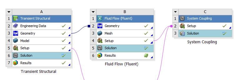

SubscriberI have simulated a two way FSI by ANSYS 2020R1. After doing all setups and execute the coupling system, I encounter the following warningÂ
Warnings were found during data model validation.                          |
| Participant Fluid Flow (Fluent) (CouplingParticipant:Solution 1) has the   |
|    ExecutionControl 'Option' set to 'ExternallyManaged'. System Coupling  |
|    will not control the startup/shutdown behavior of this participant.    |
| Participant Transient Structural (CouplingParticipant:Solution) has the    |
but the simulation was continued without error. however, when I have interrupted the run, save the project and then click on the continue calculation, I have got the following error
during the multiframe restart process the .rdb file was found but the .r file was not found
any help will be appreciated.
February 26, 2020 at 2:13 pm
Ankusham
SubscriberHave you provided time step in static structural and time step in fluent? In system coupling you also need to define the analysis time step.
These two things are ok or not please confirm.
