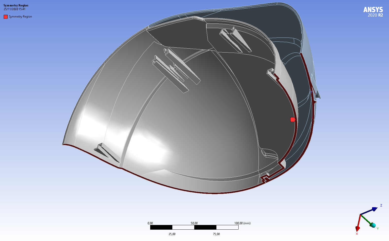

SubscriberI ask myself a question. When cutting a study in half by a symmetry region like this,
November 30, 2020 at 1:34 ampeteroznewman
SubscribernWhen the force is applied to a face that got cut in half by the symmetry plane, the force gets cut in half also.nThis green part has a force that was not cut in half by the symmetry plane so that force remains at the full value.nViewing 1 reply thread- The topic ‘Symmetry Region – post-processing of a force reaction’ is closed to new replies.
