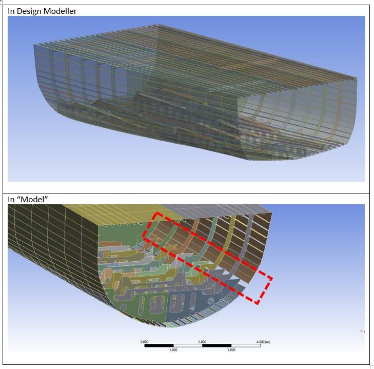

      Hi Everyone,
      Im currently dealing with a surface structure for hull section. Since, it has lots of surfaces, I have make the geometry as one part after the mesh connection & connection not work as I predicted.
      However, after making a part and update the geometry in "Model", some of the surfaces disappear. Anyone has encountered this? and know the solutions?
      With this warning, " Mass properties (volume, surface area, centroid, moments of inertia) may be inaccurate due to missing face facets: Part"
      Cheers.
      NZ

      Hi Rwoolhou,
      It seems fine in the DM as per 1st image. Total surfaces= around 269 and definitely will be increase as Im going to model the whole ship.
      I been trying different approach, for instance;
      (1) convert it in different format (tried igs, stp, rhino and even import it into the spaceclaim)
      (2) Split the surface in the CAD model (Im using Rhino) into smaller faces
      (3) Give a named selections and bring it into the model
      (4) Simplified the model by removing small items such as flanges
      (5) Make into 1 part
      Any advice on dealing with large & complex surface/shell structure?
      Cheers,
      NZ

      In DM, if you put all the surfaces in a single part, that engages Shared Topology by default. That means surfaces that have coincident edges will have shared nodes on that edge and so the elements on each surface will be connected without the need for any contact.
      I will take a look at the geometry if you want to upload the .wbpz archive file.  Say what version of ANSYS you are using.

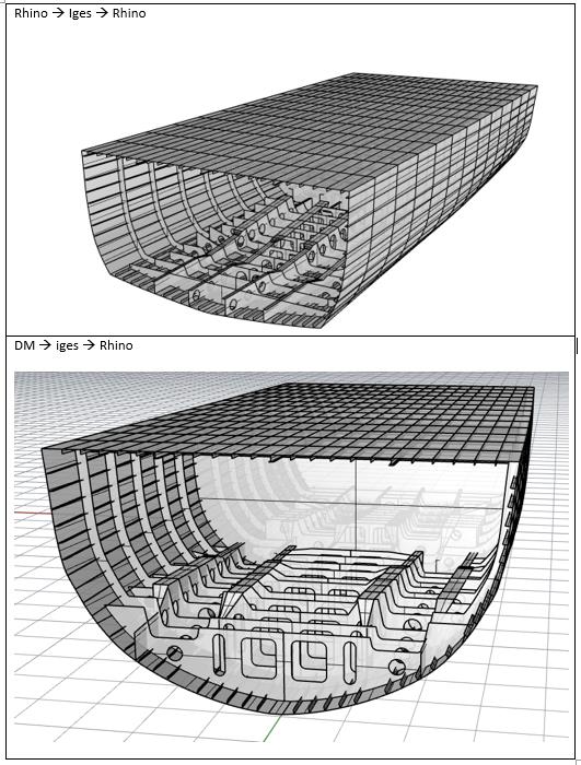

      That sounds like there's a translation issue: what happens if you read the CAD back into Rhino after exporting in (for example) stp?

      Hi Rwoolhou,
      The CAD model perfectly fine in the CAD & the design modeler as per image below. But, it became "weird" after moving towards "Model" for meshing & setup.
      Kinda stuck on meshing & boundary condition at this stage.
