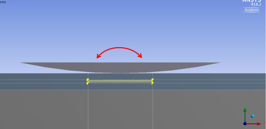

      I would like some advice on how to work with rigid bodies in Ansys Workbench in a multi-body, flexible-rigid simulation.
      I am trying to simulate a rigid 'rocker' applying a time and spatially varying contact pressure onto the pavement by rocking back-and-forth, as shown in the image below. Essentially, I am modelling an accelerated-pavement-tester.
      One way I envisaged doing this, was to split the simulation into two steps:
      In the first step, I apply a vertical force onto the rigid rocker via its pilot node, which is located at the center of curvature of the bottom rocker surface, as shown below. I will put a frictional contact between the rigid rocker and the pavement surface. Under the vertical load, both the rocker and the pavement surface would be displaced downwards.
      In the second step, I will constrain the y-displacement of the pilot-node, thus maintaining contact pressure onto the pavement, while moving the x-location of the pilot node back and forth, as shown below. This should result in a rolling action due to friction between the rocker and pavement.
      Does this seem like a sensible way to modelling this? The issue is that I am unsure how to constrain and apply loads to rigid bodies.

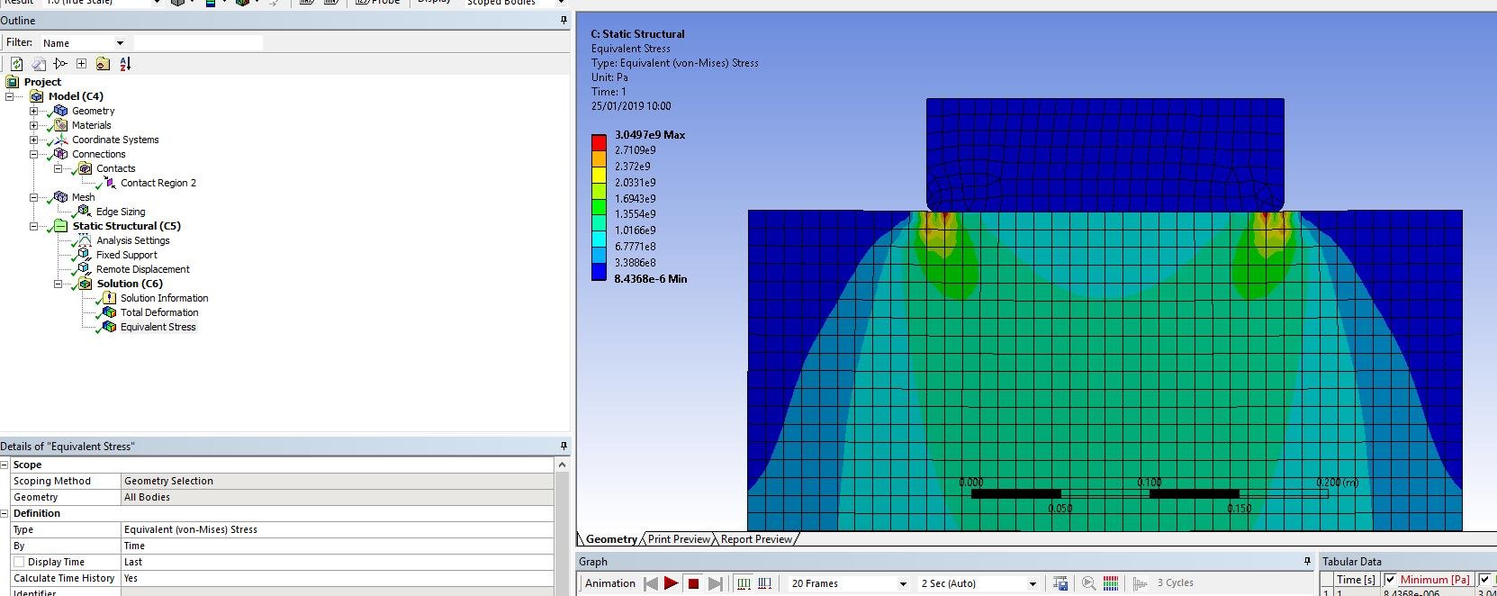

      Additional question: rigid bodies are not allowed in 2D plane strain analysis. What is the 'best practice' way of simulating a 2D plane strain problem with a rigid body? Is it to make a 3D model which is 1 element thick in the Z-direction, and constrain both Z-faces? Or to create a remote point scoped to a deformable body, but set the behaviour of the remote point to 'rigid'? I applied the 2nd method to the Hertz contact problem, and it didn't really work too well.
      Kind regards,
      Kai-Yeung

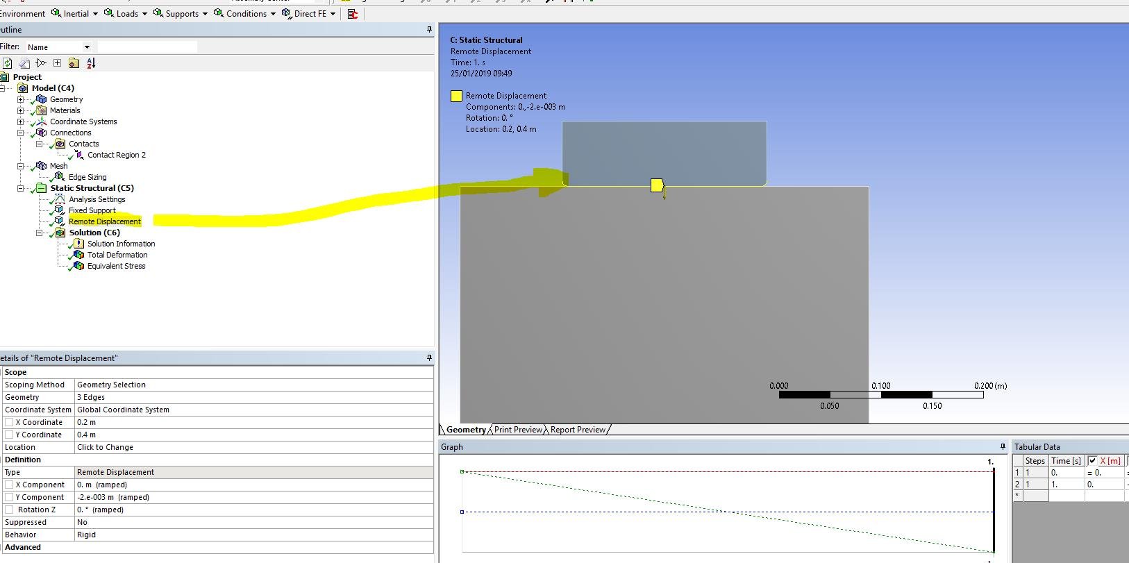

    • jj77
      I would just pick the contact edge of the rigid body (so curved edge for your part) and assign a remote displacement of rigid type, which makes that target surface rigid, so it behaves as rigid. I tried that and it is OK (see below).
    • kaiyeungli
      Hi jj77,
      I tried that, and you right correct. It does work a lot better if you define a rigid remote point on the contact edge only, as oppose to the whole surface.
