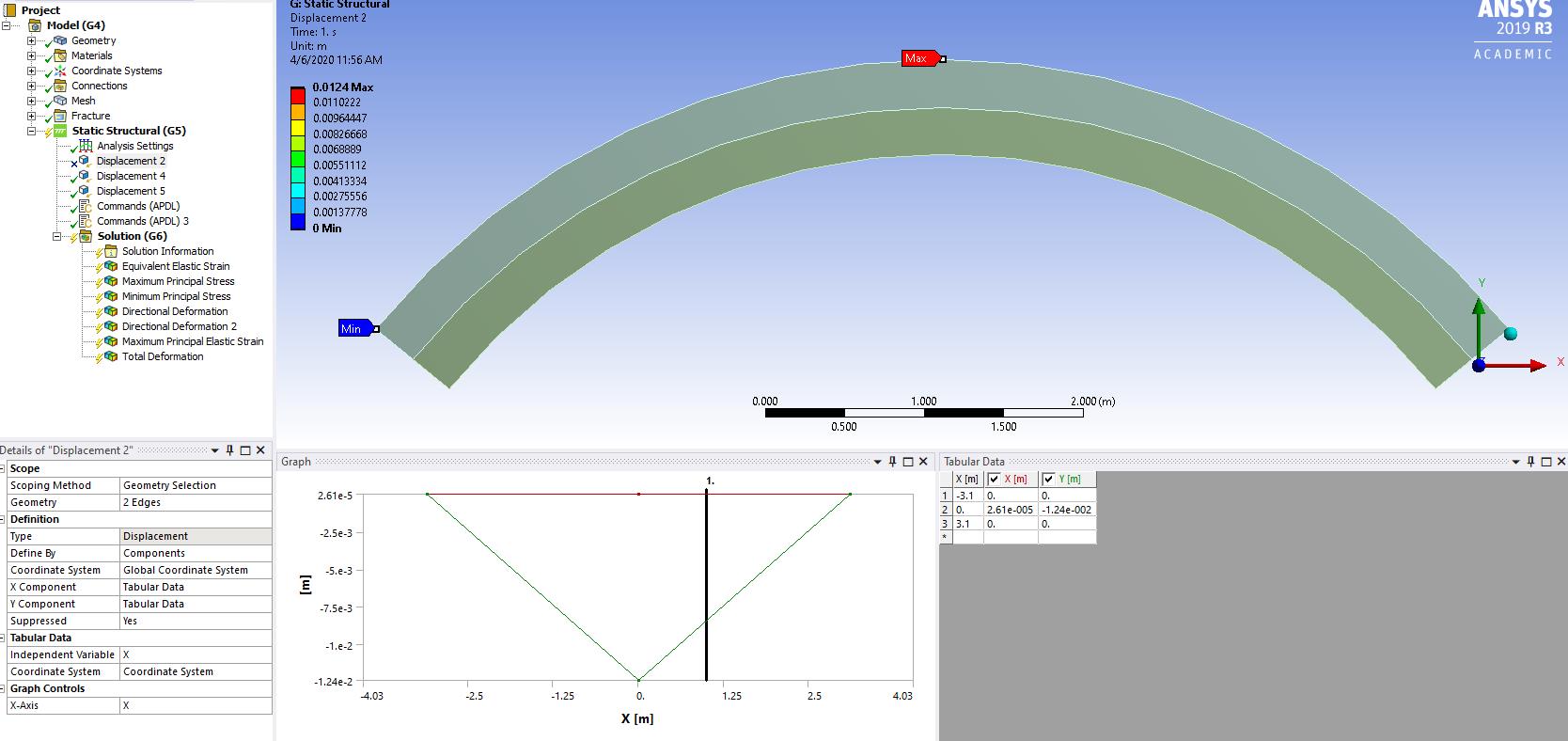

      I would like to ask if there is any possibility to parameterize a distributed load or displacement in ANSYS?(distribution via tabular data)
      Also if this is only feasible via apdl commands, I would be very thankful if anyone provides me with an paradigm  because I am not very familiar with apdl commands.
      Thank you in advance.

    • konsmi
      Actually, I am able to insert a load(in this case I inserted displacement in the centre of the upper lines of the geometry as you can observe the max indicator) and distribute it  along axis X via tabular data. But with this distribution option I am not able to parameterize the inserted displacement.
      If this is only feasible via apdl commands, I would like to give me a paradigm about how to do it  because I am not very familiar with apdl commands.

      Thank you for the response. The problem is that I can not write an apdl  script via apdl commands which will provide me the same results as I get when I distribute the load(displacement) via tabular data  manually.
