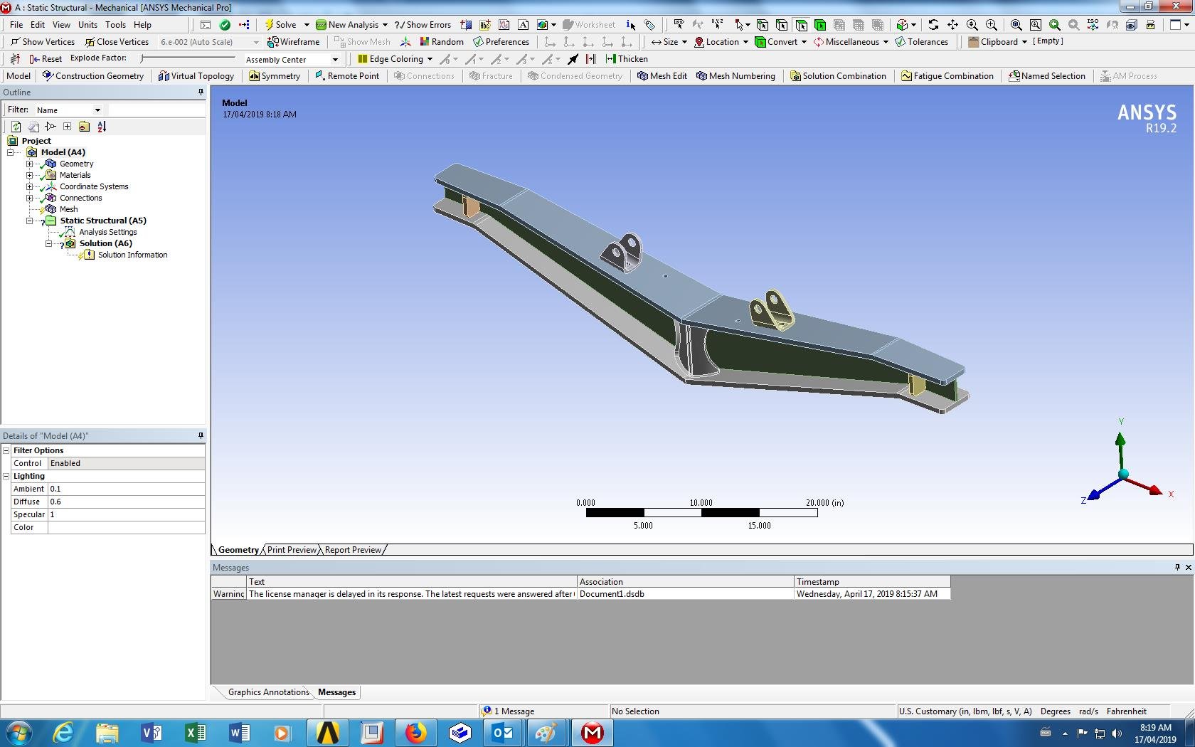

      Hi Petroznewman,
      Picture of the beam is enclosed for your kind perusal and reference. The load is being applied at the center of the beam. The force doesnt change over time. The maximum mass applied to the beam is 6086kg on static load condition. I presume that if I calculate F=mg for static load , I can use those values and calculate the dynamic load which would be +/- of value of static load.  Why I want to calculate the dynamic load is that on road where bumps or speed breakers are there 1.8G is applied on to the beam  where as in static load condition 1G is applied.
      I would like to know whether I can calculate F=mg method to calculate or not ? Is there anyother way ? I would appreciate if you could guide me.
      Thanks.

      You didn't say how the beam is supported. Is the beam hanging from a cable or is it rigidly bolted to the truck frame?  Let's assume the simple case of the beam rigidly bolted to the truck frame at those two tabs on the top.
      Let's assume the mass of 6086 kg is bolted to the beam so it never comes off and there is no cable snap to be concerned with, and the only cycles you care about are the bumps in the road. Create a point mass and scope it to the faces that support that point mass on the beam.

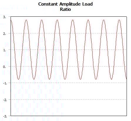

      The load cycle goes from 2.8 G downward to 0.8 G upward. The range is -0.8 to 2.8 which has a mean of 1.0 and an amplitude of 1.8.

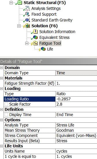

      Use a Static Structural model, add the fixed supports, add a Standard Earth Gravity load, add an Equivalent Stress result and add the Fatigue Tool.  In the details of the fatigue tool change it to Ratio and enter these values and pick a Mean Stress theory. Then insert a Life calculation into the fatigue tool to calculate cycles to 50% probability of failure.

      How do we calculate a point mass ? Whats the standard earth gravity load ? Whats the reason to choose the loading ratio -0.2857 to be choosen ? Why scaling factor is 2.8 ?
      Can I choose the cycle units to days ? After evaluating, Fatigue tool > life> results > minimum ? The minimum value mentioned is the value of its life cycle ?

      To create a point mass in the Model in the Mechanical program, RMB on the Geometry branch of the Outline, Insert > Point Mass.  Now pick the faces that support the mass. Faces that the mass would be bolted to or welded to. These faces will carry the weight of the mass in under the gravity load.
      You have a Static Structural analysis so click on that title in the Outline.  Now on the Environment toolbar, you can see an Inertial button. Pull down on that and you will see Standard Earth Gravity.  This creates a 1.0 G downward load on your model. You will also see the Supports button to create Fixed Supports, though you might have something more appropriate for your connection to the saddle, like Remote Displacement that leaves some rotations free.
      For the fatigue calculation, you want 2.8 G downward load, hence the scaling factor. If you play around with the ratio, you will find that if you type 0 then the bottom of the sinusoidal load will be 0 G, while if you type in -1 the bottom of the sinusoidal load will be -2.8 G.  You want the bottom of the sinusoidal load to be -0.8 G and if you use a loading ratio of -0.2857, that is what you will get.
