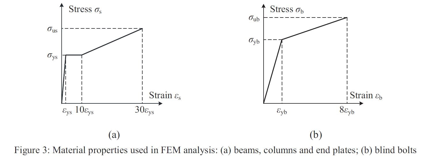

Subscriber i study model with non stress strain curve how could i define it in ansys material (multi linear isotropic hardening)
when calculate these values:
True Strain = ln(1+Strain)Â Â where ln is the natural logarithm function.
True Stress = Stress(1+Strain)
Elastic Strain = True Stress/E
Plastic Strain = True Strain - Elastic Strain
where:
fy=309 mpa
fu= 580 mpa
E= 210 gpa
i get:
but the deformation decreases from 0.006 to 0.001 and still solve linear i don't know what is the problem
