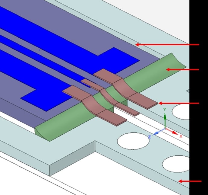

      I am new to Simulation and my task is to find the stress between Adhesive and Contact as shown in the Image(Stress Simulation _Adhesive and contact).
      The adhesive is placed between Substrate and chip for isolation. But as the adhesive solidifies it deforms, deforming the contact. Thus, by simulation i would like to know the area with minimum stress.
      Problem is in defining the Physics. Below is the Physics defination:
      Location in Physics region as 8 volumes ( 6 Contacts and 2 Adhesive) [The image shows only one side of Construction]

      I'm pasting your image inline for the ANSYS staff who are not allowed to download attached files.
      I think you are showing:
      • Adhesive is green solid,
      • Chip is purple with blue conductors,
      • Substrate is light blue,
      • Contacts are brown
      • Base with rib is white.
      I assume the blue conductors on the chip are just modeled as a face carved into the rectangular chip solid, and not a separate solid?
      Can you assume the Base and the Substrate are one solid for this analysis and are united (merged) together?

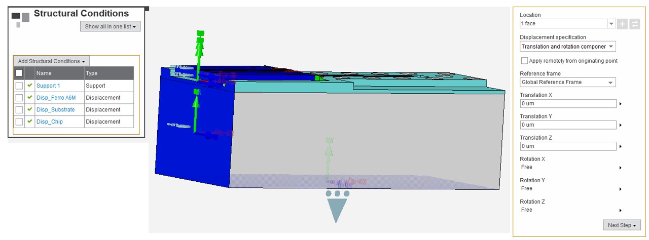

      When you cut the model in half, I expected to see either a Symmetry condition in the model or a Displacement of X=0 on all cut faces. Please show me that. Without that, the chip will just shift past the symmetry plane.

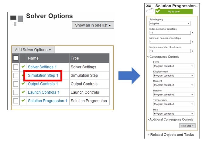

      Physics > Solver Options > Simulation Step 1 > Solution Progression 1
      Change Substepping to Adaptive and change Initial number of substeps to 10.
      That will help the solver converge on a solution.

      I just need some basic help and will try to explain in the images below.
      Yes, Displacement along with support is defined and can be seen in the image below.
      I did the changes and are presented in the image below:

      On the cut faces, only X=0.  Y and Z should be free.
      That won't change the fact that AIM seems to be trying to solve a Thermal problem.  In Workbench, I can have a Static Structural model that has a Thermal Condition load such as I suggested above.  That does not invoke a Steady-State Thermal solution. I don't need to solve for where the heat goes or what temperature all the other parts are, I just need to increase the temperature of that one part to get it to expand according to its CTE.  I don't know if you can do that in AIM. If I uncheck Thermal in the Physics Region, then the Temperature boundary condition flags an error.
