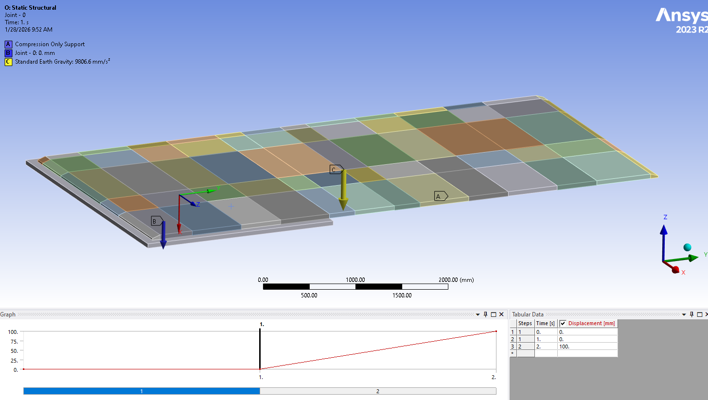

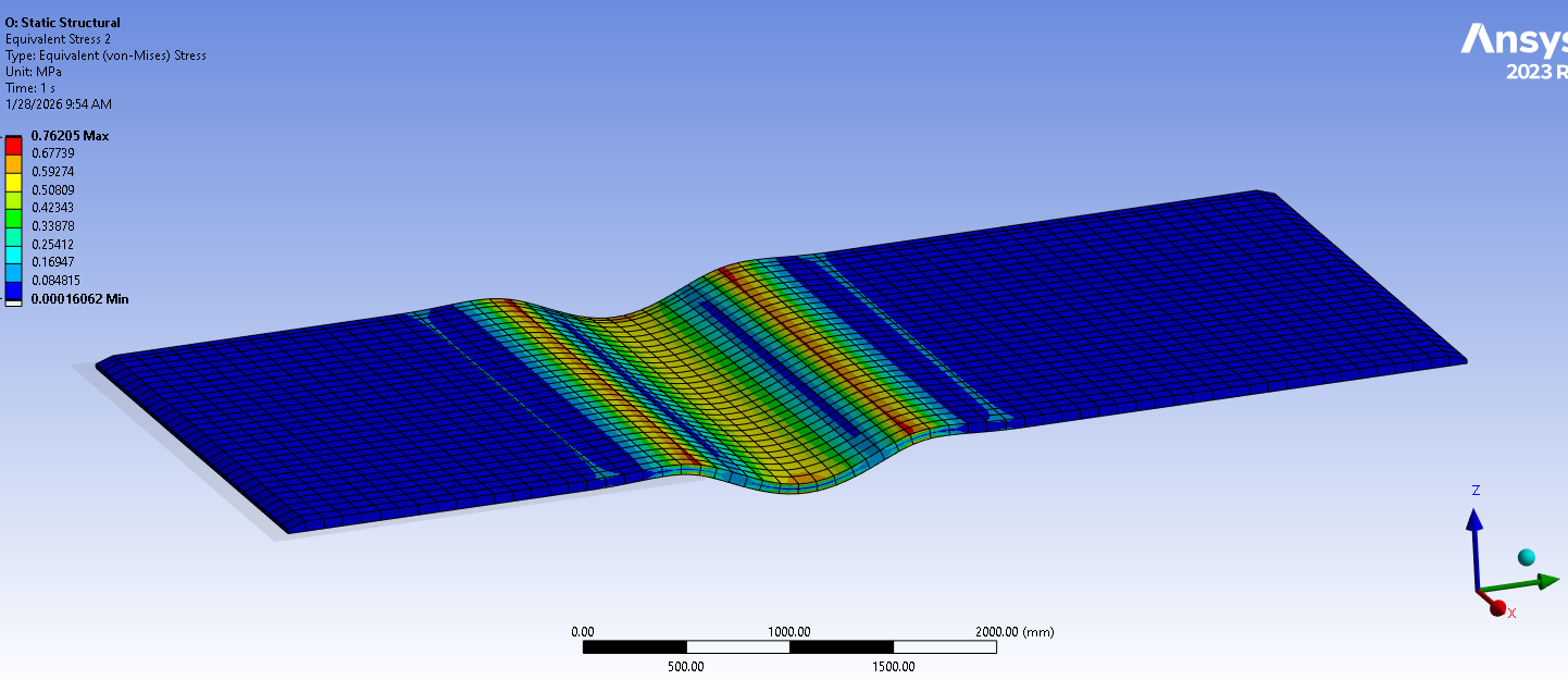

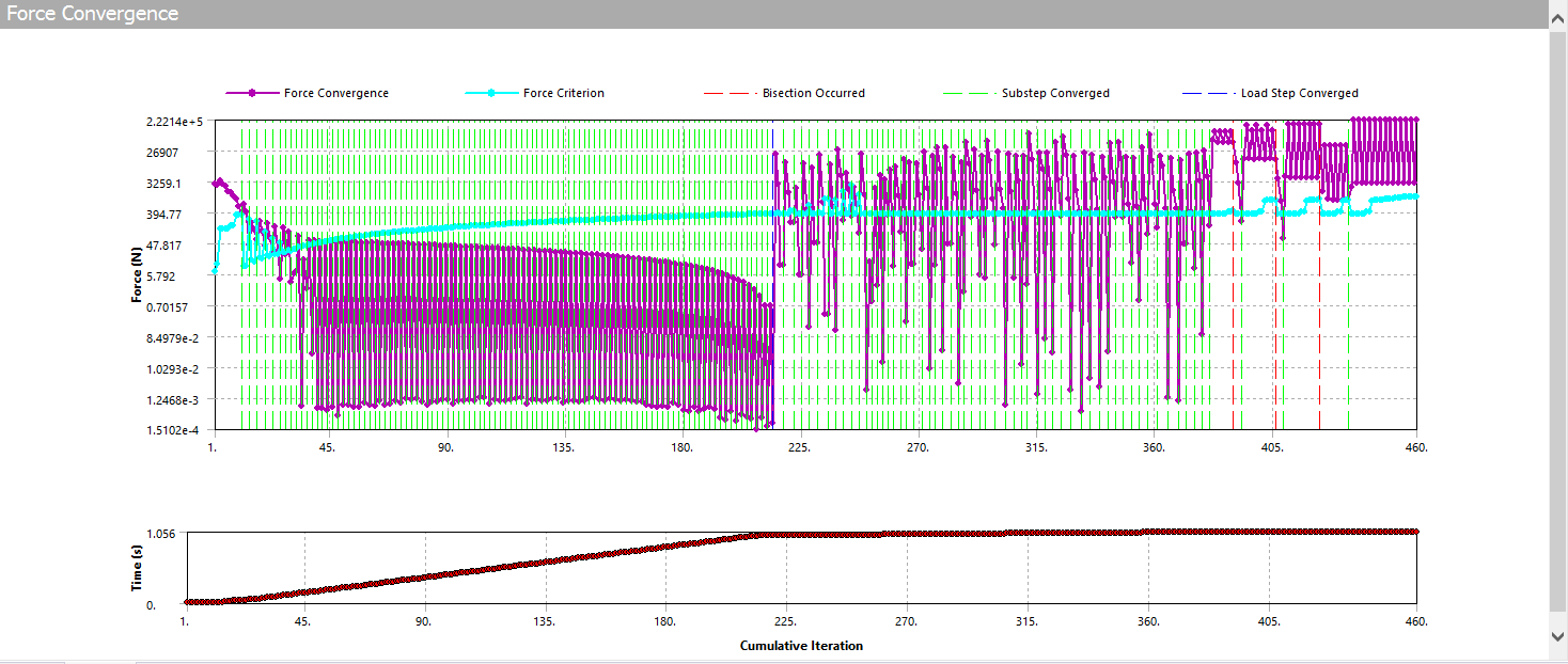

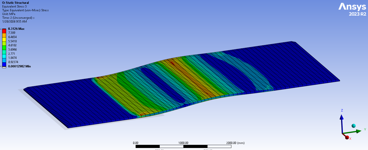

        Thank you for the tip. I've tried your suggestion by modelling one of the rigid body. Just like you said, I practically divided the analysis into two steps, step 1 (gravity only) and step 2 (the displaced translational joint to ground).
        The analysis is able to converge in the first step, but it fails in the second as soon as the displacement is introduced. I've defined initial substep of 100, min 1000 and max 1000, turning large deflection on and added damping to the contact. Have you got anymore tips that might help?
        here's the snapshot of the force convergence
        and here is the snapshot of the model and BCs
        heres the result for step 1, it is as expected
        and heres the result of step 2 (unconverged), the shape somewhat make send although it doesnt converge

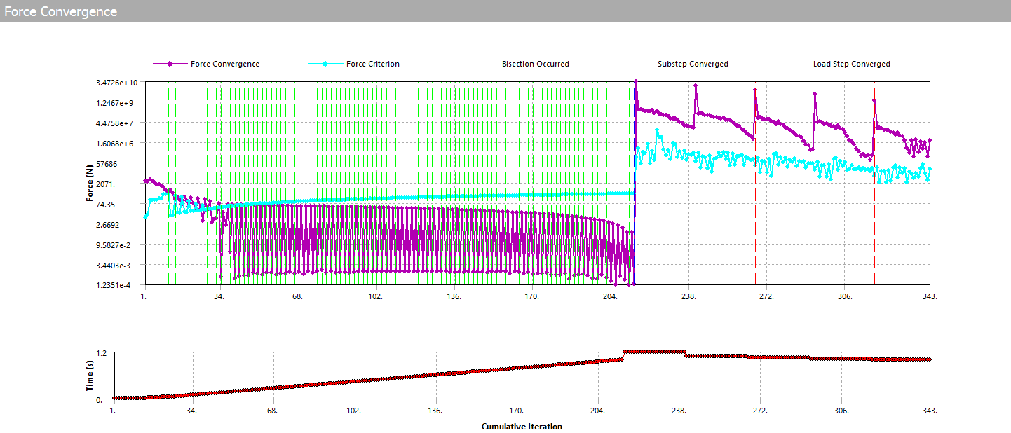

        additional info, In the previous screenshots. I displace the body about 100 units (mm), Ive also tried only displacing it by 5 mm and 10 mm in 1000 (1000min - 1000max) initial substep in step 2. The convergence problem still exists, on top of me refining the target mesh (where I found newton rhapson residuals). On top of that I also added a translational restraint to the corners of the plate that is expected to always touching the target body to (what I suppose) assist convergence.
