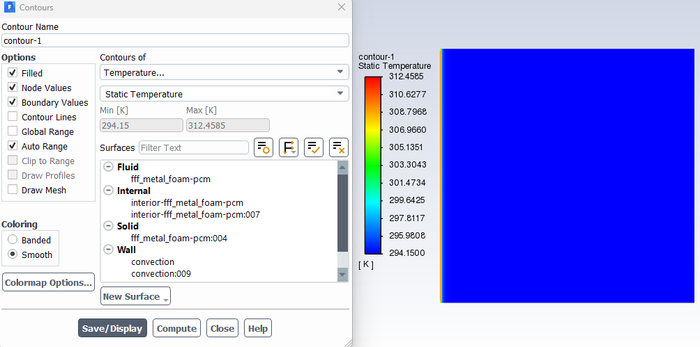

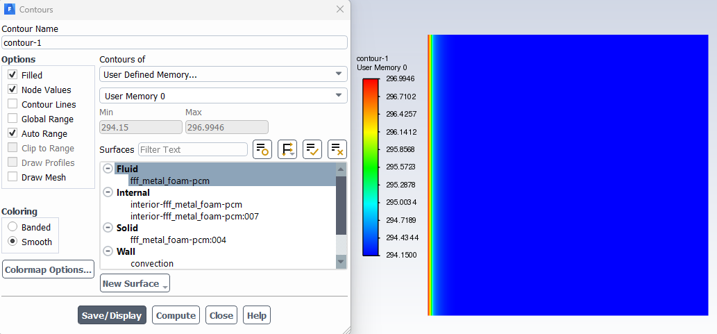

      It doesn't store the value at boundaries, so how to store temperature boundary values, or did I make a mistake?

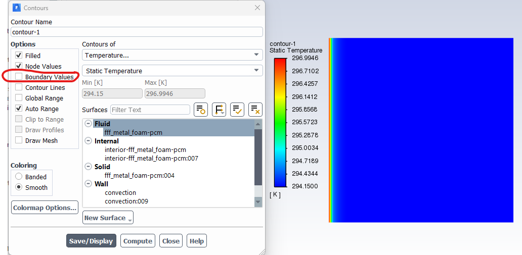

      When I compare the countors by UDMI and fluent post it shows different temperature values unless I deactivate boundary values in fluent, fluent will show the same contours of the UDF (Image Attached)
