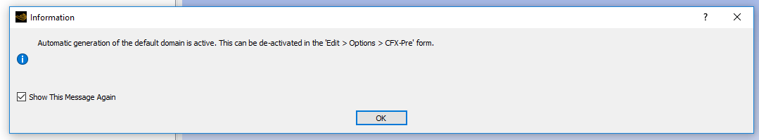

      Good morning, sorry for the disturbance but I am trying to write the set-up of the ANSYS CFX tutorial on the steam jet (https://ansyshelp.ansys.com/public/account/secured?returnurl=/////////Views/Secured/corp/v242/en/cfx_tutr/i3385293.html) but the solver returns the error 'Error finding variable "PSAT_FL2" within domain "Domain". CCL is possibly invalid.'
      Would it be possible to ask you for the courtesy of the already ready set-up to see where I am making a mistake? Thank you for your patience

      At what point do you get this error? Based upon your limited description I would guess your error comes when trying step 29.4.2. If that is the case, your probably do not have automatic generation of the default domain activated. When you start CFX-Pre after creating new case, do you get the following message?
      If not, then do the opposite and turn it on. Hopefully that solves your problem.

      The error appears when I run the programme and launch the Solver Manager.
      The message doesn’t appear when I launch Ansys CFX, although I always start with a Default Domain; I’ll try again on Monday.
      I had also thought (wrongly) that perhaps the CEL variable was incorrect, so I entered the value "1 [bar]" directly instead of "Liquid.psaturation".
      In this case, the error changed to:
      | ERROR #001100279 has occurred in subroutine ErrAction. |
      | Message: |
      | Failed to calculate sources in GETSOU for RESSRC_A from director- |
      | y "" at location "Condensation". Error return code is: FAIL |
