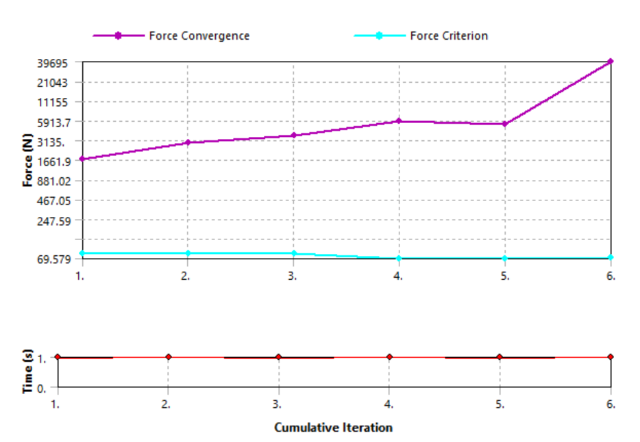

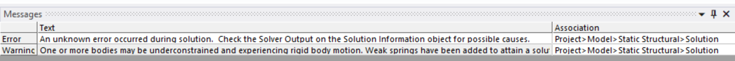

January 18, 2021 at 1:41 pm
boonthiam13
SubscriberPeter, the full solution output is attached. There is no error message in the solution information but there is an error message associated with warning message as below:n
nAs you mentioned, appearance of the red lightning bolt is because of the solver stopped before it got to the End Time. What is the possible cause leading to this as I didn't stop it halfway.nI attached the force convergence plot as well as the details of analysis setting for your reference. Very much appreciate your kind assistance. Looking forward to hearing from you soon n

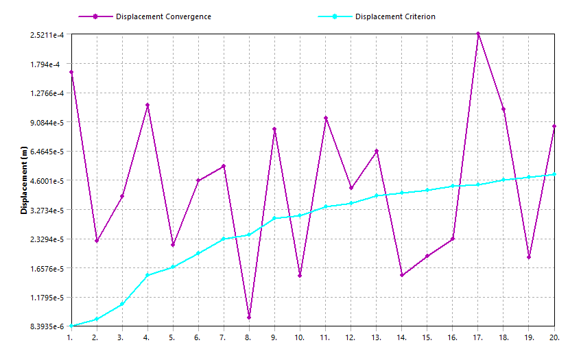

January 19, 2021 at 11:36 pm
boonthiam13
Subscriberpeteroznewman nHi Peter, I just realized that in my model, ANSYS has selected displacement as the convergence criteria, rather than force. Why is this happening and can we consider the model is solve if the displacement has achieved full convergence? Also, the iteration stops at 20 and did not continue further, how should we tackle this issue?n

February 2, 2021 at 4:07 am
peteroznewman
SubscribernAnsys typically selects two or three criteria to check convergence. You can choose which one you want to plot. nThe way to fix this problem is usually to change the Analysis Settings.nTurn on Auto Time SteppingnSet the Initial Substeps to 10 or higher.n
