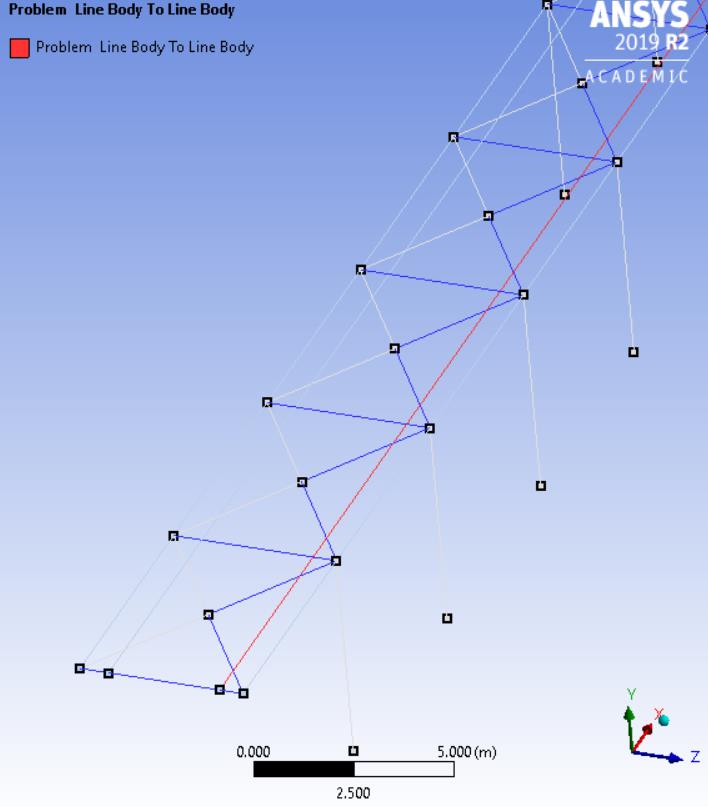

SubscriberThe model has Bonded contact of 1 red edge to 61 blue edges.Â
I don't know why, but that bond is causing a problem, while the same one on the other side does not.

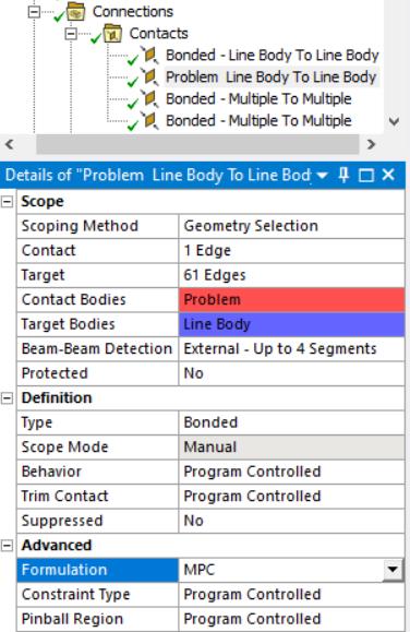

The fix is to change the Formulation of that Bonded contact to MPC.

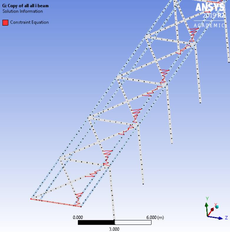

Then, after a Solution, you can click on the Solution Information folder and then click on the Graphics tab to see the CE elements on the display that shows which nodes were tied together by the Bonded contact as shown below by the little red lines. The mesh size shown is 500 mm.
Is that how you want that long beam tied to the diagonals?
