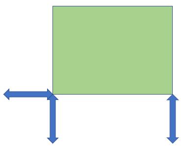

      Liam,
      Here is an illustration along the lines suggested by jj77: add three springs to ground in the XY plane to support the screen in that plane.  These springs can be 10 times stiffer than the springs in the Z direction.

    • liam
      The springs have been added as shown with 4 springs acting in the Y direction and 8 springs (4 acting in positive X and 4acting in negative X) direction.

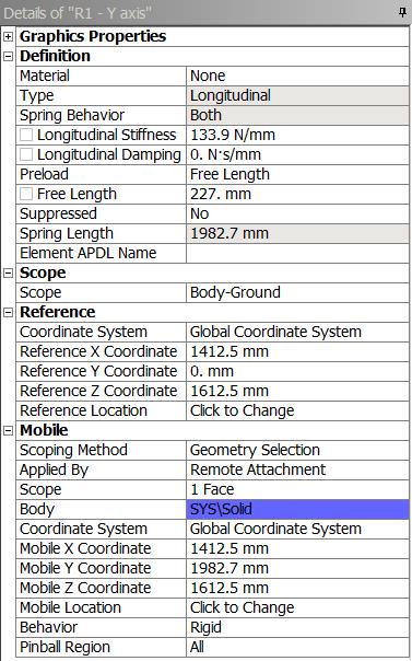

      I wrote out the input.dat file and there are element ID numbers like 38134. The Student License checks if highest node or element number is < 32000 to allow it to run. I agree with jj77 that the thin wall geometry should be replaced with a mid-surface and use shell mesh.
      I found one mistake that contributes to the Static Structural not converging. You want the Y axis springs to balance the weight of the structure by their combined preload force. The Preload was defined using Free Length, which is 227 mm, while the Spring Length is 1982.7mm which means the spring has been stretched by 1982.7 - 227 mm. generating a huge Preload force in the wrong direction; tension.  You want the Free Length to be longer than the Spring Length so that the preload force is in compression.
      It may be easier to get close to static equilibrium by defining Preload by Load instead of Free Length, then you can take 1/4 of the weight and assign that as the spring load, using a negative sign to create a compression force that will support the weight of the structure.

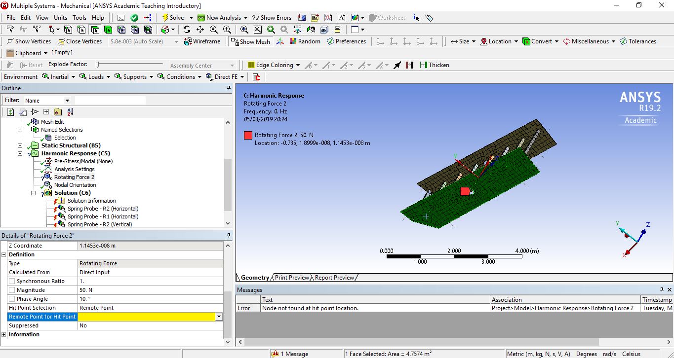

    • liam
      I have finally transferred the entire model to a usable state using the advice you have given me!
      I cannot thank you both enough although i am now presented with another problem, I cannot get the rotating force to work for the harmonic analysis.
      It will not select a node hit point for me.
    • jj77
      You can use a remote force load, that can act on a face edge,...
    • liam
      An option is presented for this but not giving me a selection to carry this out

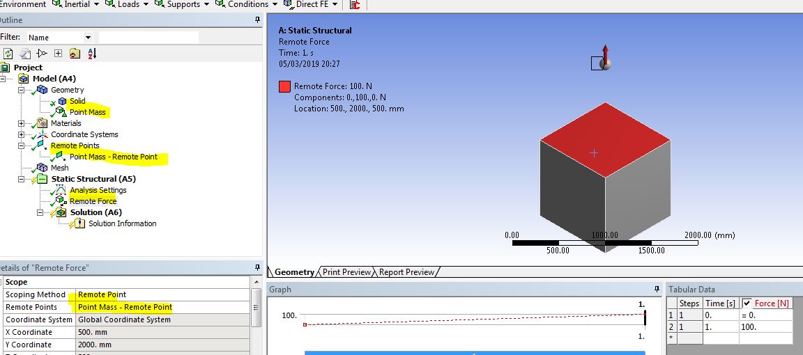

    • jj77
      Many times for machinery one uses a point mass fro the cg,and the all unbalanced forces are applied there. Can do that with a point mass, right click on and select promote to remote point, the finally apple a remote force there. see below for details
    • liam
      When I open the drop down highlighted in yellow no further options are presented.
    • jj77
      Rotating force is only for full and coriolis effects on, so rotating equipment.
      So do as I have shown with the remote force or remote point and define to components that are 90 degrees out of phase

    • jj77
      So do as I showed that is define a point mass and promote to remote point (right click on point mass and select promote)
      Under remote point, you can set an apdl name, here I called it say cg (for centre of gravity of equipment)
      Then add the commands below as a command snippet under the harmonic resp/ and where BC and loads are applied.
      These are two forces that are real and complex thus in the complex plane they are 90 degrees out of phase, which is a rotating force on the point mass called cg. THe out of balance load is m_outofbala x radius x omega^2
      f0 = 100
      f,cg,fy,f0
      f,cg,fx,,-f0
      This is what you need, select Is Solution to close this discussion.
