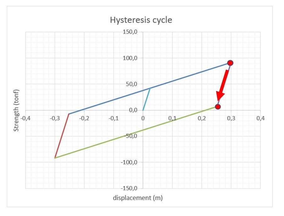

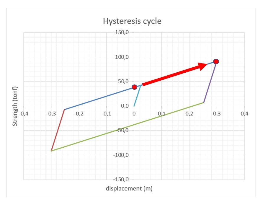

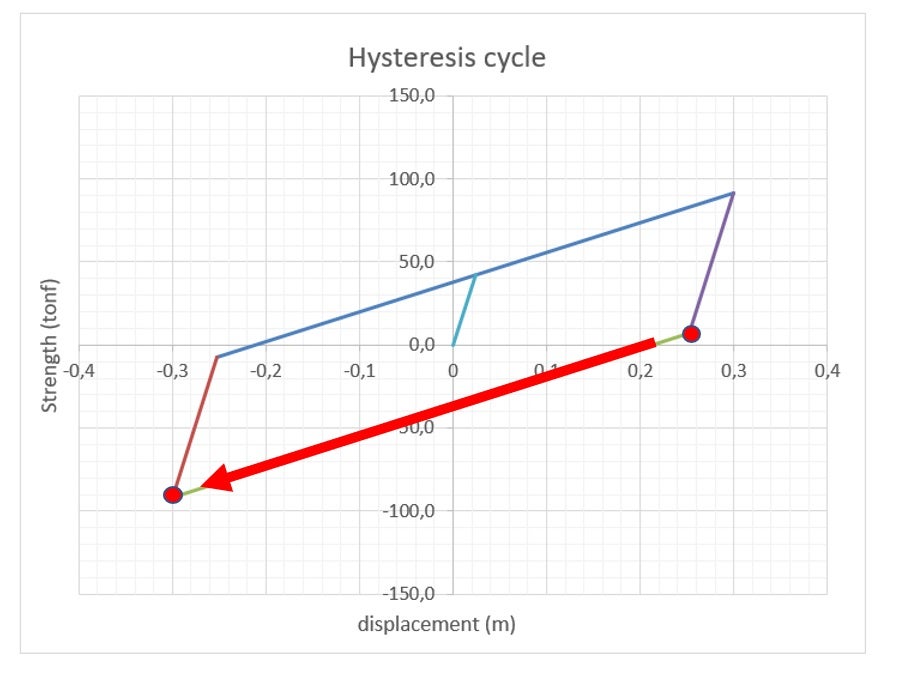

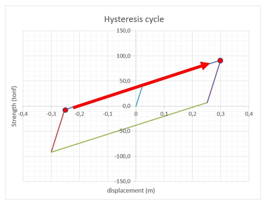

      What I have to do is apply a load acceleration vs time
      To a structure that is supported on these springs, which as out, hysteresis curves of this style should be obtained.
      The load has to follow the following path to form the hysteresis form.
      1)
      2)
      3)
      4)
      5)
      6)
      And in this way complete the cycle, that is, when receiving loads of acceleration, force or displacement, to be able to obtain that cycle and hysteresis.
      So far I have been able to make the bilinear spring model, as explained in other posts, that is, I have been able to complete image 1 and 2 with deformation input, however, I do not know how to continue, I tried inserting damping in the code , but it doesn't work for me, I can't get stage 3 of the model, that is, when I unload the spring, it has that slope.
      I am using combin40, with the following test code

    • Sheldon Imaoka
      Hi Mike,
      Instead of COMBIN40, please take a look at COMBIN39.  Even though COMBIN39 is used for multiple points, you can have a bilinear representation.  KEYOPT(1)=1 will allow for unloading on the original (initial) slope.
