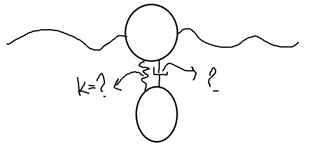

SubscriberHello,
I was wondering if there is any way to model a linear connection with spring - damper characteristics to a structure in AQWA? As far as I am concerned, we can use cable with stiffness, but there is no option to define damping.
Thanks,

Ansys EmployeeHello Medi,
could you please tell us more about what you are trying to model?
In the meantime, if you want to model the damping that acts in extension, you can use the external user force. You have some examples and a README in your installation, under the aqwa\utils folder. You can start the server as a pre-solve command (see section 5.8.1 of the Aqwa User's manual).
Kind regards Ingrid
March 16, 2022 at 4:58 pmMarch 21, 2022 at 11:56 amIngrid M
the external user force (in your installation directory) is the way forward. Look at the examples provided. This requires a bit of simple python coding though.
Your spring force is proportional to the elongation (you have access to the position) and your damping force is proportional to the velocity (which you also have access to).
Kind regards Ingrid
