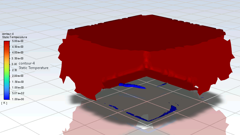

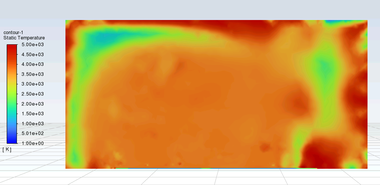

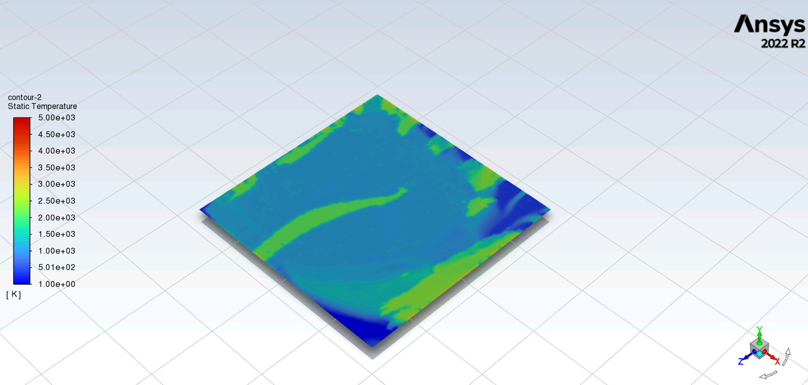

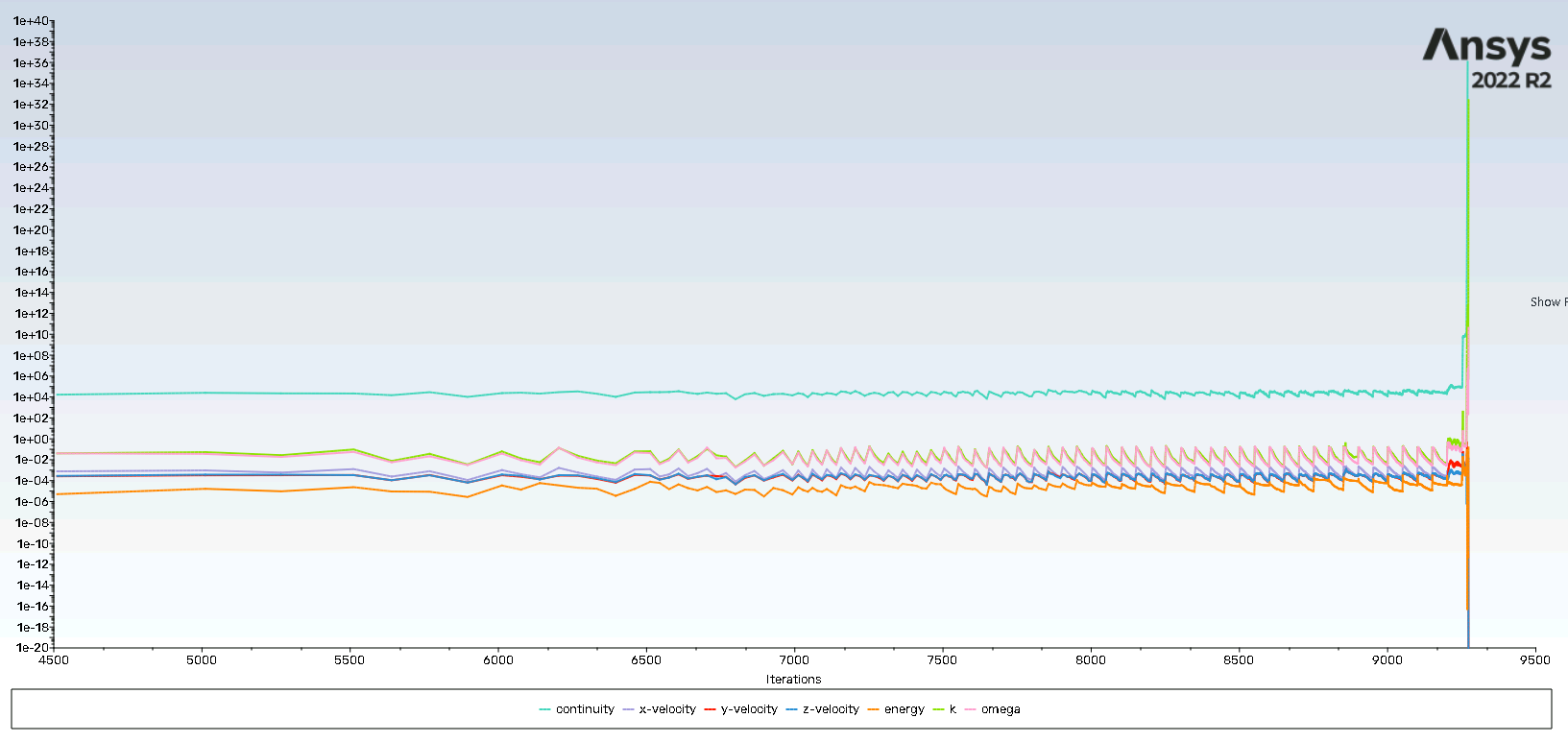

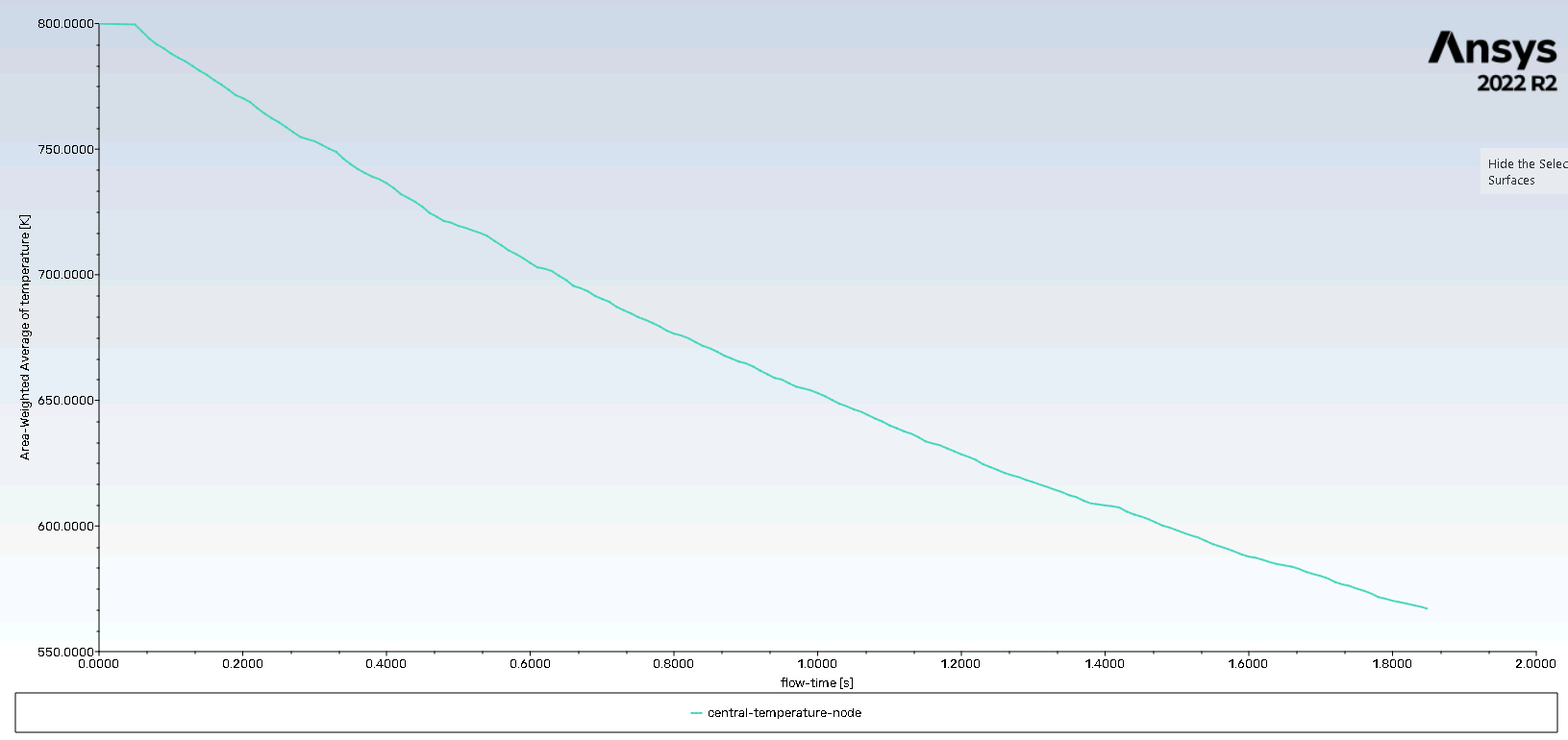

SubscriberHello,
I am trying to simulate the transient cooling of a flate aluminum plate from an initial temperature of 800K to the DPM liquid temperature around 300K using a flat fan atomizer dpm simulation. I am running into an issue around 1.6 seconds into the 5 second simulation, ~9250 iterations with 50 iterations per time step, the residual values explode causing a floating point error and a bunch of cells limited at 1K or 5000K. I have included a few figures which show the locations of the 5000K and 1K cells and the temperature gradient on the surface at the last time step. Up until this last time step the simulation is able to run and shows the plate cooling a rate that is expected. I have a minimum orthogonal value of 0.1 and average of around 0.8. I can answer any questions you have for me, but any help would be greatly appreciated.

I assume that this is a transient run? If it is, the failure point will coincide with a certain point in the analysis, such as the spray just arriving at the hot plate. This is the first thing I would try to pin down. If the dpm particles are not at the plate yet, then the failure may be due to cht numerics.Â
It looks like the environment is getting up to 5000 K. This is very odd and may be related to the boundary conditions placed on the cube of air around the plate, or something to do with particles Something is producing this heating. Some questions to ask:

- As you run, do any of the equations show very high residuals?

4) I am using an inert water liquid droplet, an aluminum plate, and standard air all basic for ansys fluent, I will have to check for these values if they are critical. I will share a link to a youtube video of the first 1.8s of the simulation, you will see that this isn't an issue at all until this random iteration.Â

6) From the figures shown in the post, the continuity equations are always greater than 1, never converging under that. Then at the 8000 iteration it blows up.

If it is blowing up at a certain iteration, I would try to stop the run just before then and take a look at the solution in detail. With particles, the isues can come from many things. Unfortunately, with transient operation, there are not as many underrelaxations that you can do, so your only option is generally to reduce the timestep. If it is possible to inject more representative particles for the spray, this may be beneficial too.
Expanding the box around the plate may help to stabilize the boundaries because conditions there are more likely to be predictable, (ie: ambient temperature with little flow). A hemisphere type boundary shape may help to give a better mesh and prevents directional wierdness at corners. Flow at the boundaries should come back in from nearest cell and not normal to the boundary.
