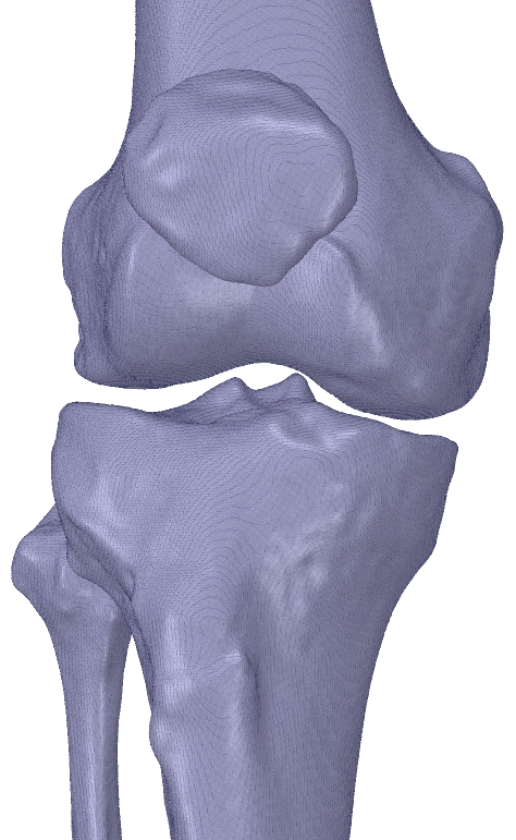

      Hello Elisabeth I was able to locate better quality knee bones in STL file format. We can discuss how to convert STL files to geometry that can be meshed.

      Hello Peter That you for the stl files ! It will be great with the patella ! We can discuss about how to add cartilage and ligaments to this geometry too.
