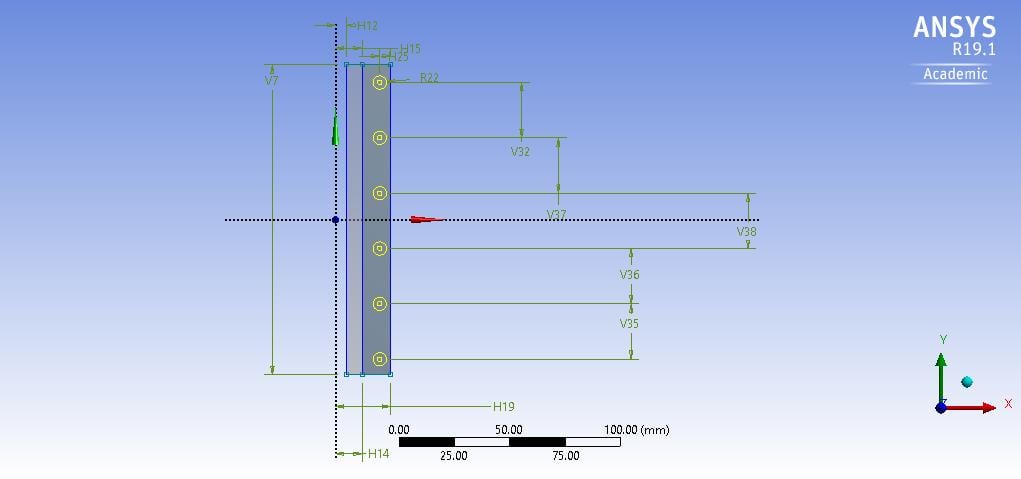

      Thank you Peter for your response. It is actually a rectangle which is shown above in 2D. When rotated around centre axis it makes a composite cylinder. So if I make a hole in the outer cylinder. It will be axisymmetrical rotated to form an empty ring within the cylinder. In Real life it will be achieved by 3D printing the outer cylinder.
      Peter can you please guide me through the steps to perform a heat analysis. How to create a spiral body element on the outer cylinder to perform heat dissipation analysis. ?
      Please make a sketch and write down all the known boundary conditions and material properties. Insert an image of that sketch into your reply. Let's do the 2D model first.

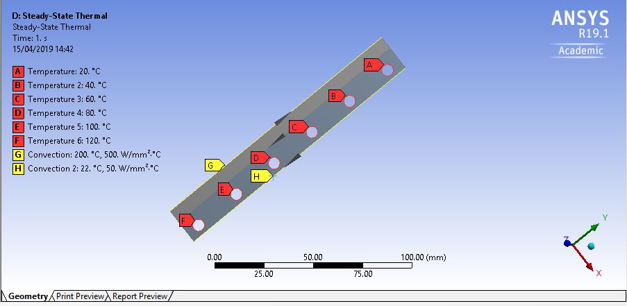

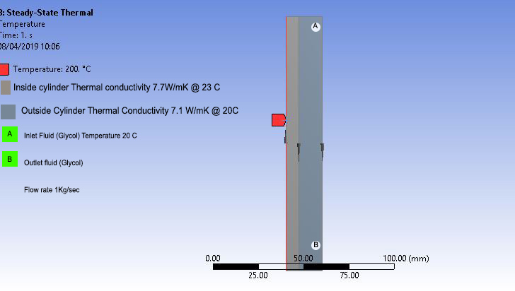

      I did a sketch and tried to write know boundary conditions. If there is something left please let me know.
      You need a couple more BCs.
      The outside face of the cylinder, is that convective cooling to the air?  What is the convective heat transfer coefficient?  What is the air temperature?
      Since this is a learning model, let's assume the temperature on the two circles representing the cooling fluid are 20 C at the fluid inlet and 100 C at the fluid outlet. I just made up that last temperature. When you build the 3D model, you will solve for this temperature, but for this 2D learning model, we will specify it.  When you do the 3D model, you will need the convective heat transfer coefficient of the fluid to the spiral wall.
      If you wanted to put in a three more holes between A and B, you could set the temperature of those holes at 40, 60 and 80 C.

      I was unable to find convective heat transfer coefficient and was told to assume a value for the worst case scenario.  '
      The outside face of cylinder is room temperature and convective cooling to air.(atmosphere)
      Air temperature is 22 degree C
      The inlet temperature of fluid is 20 degree C
      i know the diameter of spiral and length also pitch.
      In the mean time I have attached the model picture with  the circles I draw on the 2D model and need to create an empty space. Which tool i should use which will remove material in the circles.
      There are several ways of making hole, but you can also just imprint the face with the circular edge and assign the temperature to the circular face.
      Try Extrude with the option to Cut Material.

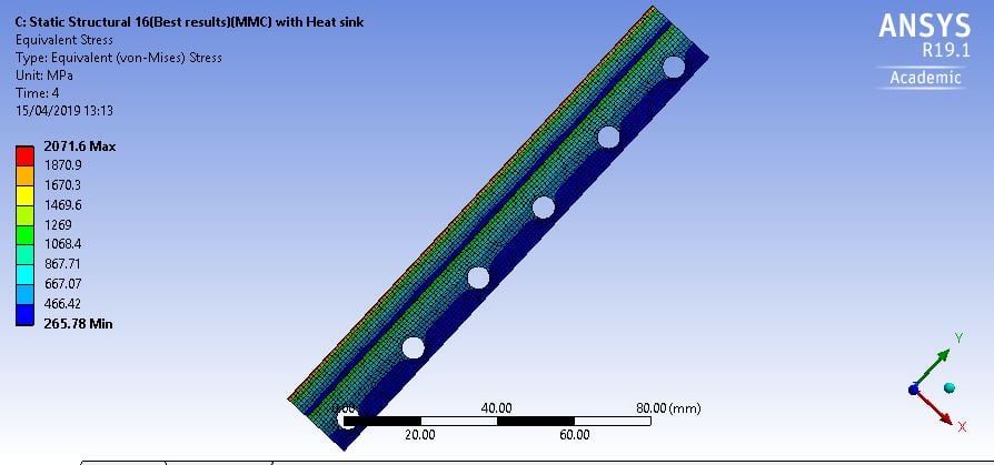

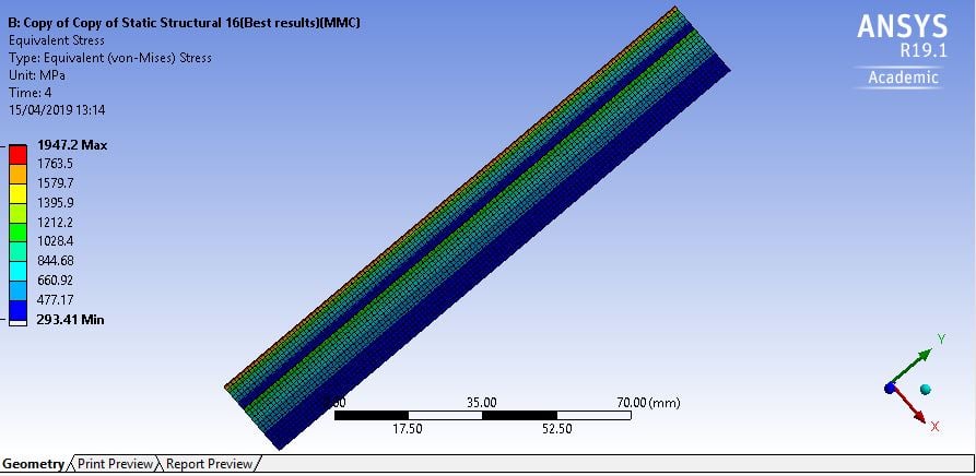

      I cut and extrude and here are the Von misces stress results which doesnot show much of difference but looks promising.
      I hope its a good approximation of spiral structure.
      Regarding thermal analysis I have applied all the boundary conditions. I need to keep the inside liquid temperature in between 20 -120 centigrade.
      I think to find the convective heat coefficient i have to go for a 3-D model. Temperature assigned on each hole are rough guesses. I need to work out the actual heat which this coolant is capable of carrying to make sure that inside liquid temperature remains in the range.
      Looks good. You could have left the inside wall as a Temperature BC of 200 C.
      How does the temperature distribution look?
      Yes, you will have to build a 3D model with a spiral to get the true fluid temperature in the spiral.

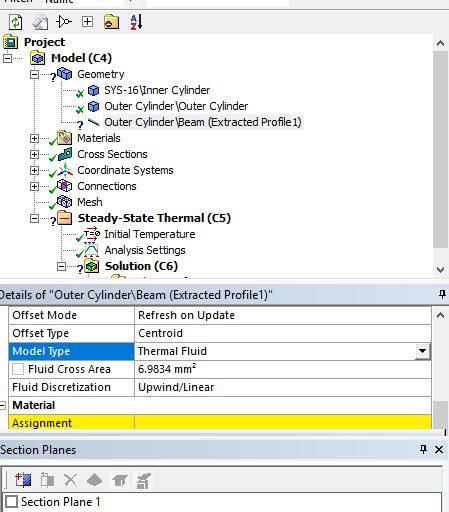

      I have extracted a beam on ansys using the extract beam command. The results are displayed as shown
      When i move it to the mechanical only half of the model is displayed. Because I may have applied section view. Moreover what material assignment should be applied to beam since it is just an empty space where cooling liquid will be passing thorough?

      I think you override the Beam element and define that mesh with a FLUID116 element by using a Command Object under the Line Body.
      Read the ANSYS Help on that element by pasting the URL below into the ANSYS Help window that you must first open.
      https://ansyshelp.ansys.com/account/secured?returnurl=/Views/Secured/corp/v192/ans_elem/Hlp_E_FLUID116.html?q=fluid
    • hassam
      Hi
      Thankyou peter for your response. I have given the Model type is as thermal fluid in definition. Its still asking for the material type. It would be much help if you could elaborate the statement
      " override the Beam element and define that mesh with a FLUID116 element by using a Command Object under the Line Body"
      This discussion has an example of overriding a beam with an element type LINK180.  You use same method, putting a Command object under the Line body, but instead of et, matid,link180  you would use et, matid,fluid116 and then on the following lines would add any other commands needed to define the properties of that element.
