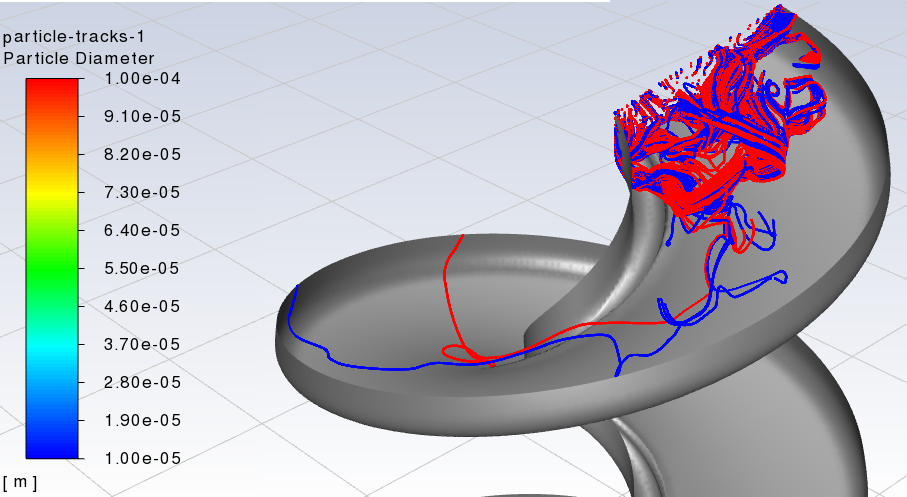

Someone can give me an orientation about this simulation in fluent?
First. I'm trying to simulate a spiral concentrator with DPM with the next parameters:
→steady state analasys
→Gravity in Z direction: -9.81 m/s2
→Viscous model: RNG k-e model, swirl dominated flow condition
→Discrete phase model:
December 17, 2021 at 5:11 pmJohn Ibrahim
Ansys EmployeeHi Jeffer I recommend you to switch to steady tracking and make it one way interaction. That means you uncheck the interaction with the continuous phase. You need to converge the continuous phase very well do the particle tracking at the end and find out if you get the trajectories at the outlet or not. Keep in mind the particles are very small so one-way interaction is a good assumption. Try this first and let me know how it looks like. When plotting the particles, please display the outline of the bc so we can find out where the particles are stopped

December 17, 2021 at 5:52 pmRob
Forum ModeratorAlso check the spiral "upper" surface. Why are you seeing flow boundary markers on it?

December 21, 2021 at 2:50 pmRob
Forum ModeratorWhy are the particles not penetrating into the fluid? They should follow the flow, unless you've injected them on the outlet or got gravity pointing in the wrong direction.

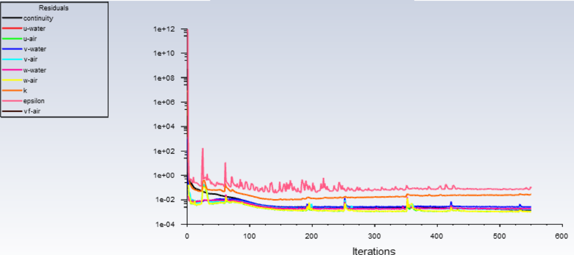

January 7, 2022 at 12:03 pmjeffer
SubscriberHi I'm still trying the simulation

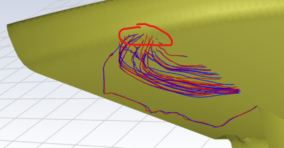

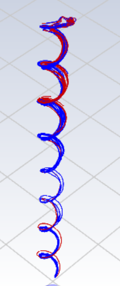

First, I've injected the particles from 'inlet' with the same inlet velicity that the water
and now I turn on the multiphase and put the Eulerian, with 2 Eulerian phases; water and air, and a discrete phase; particles. In this case I got to good residuals, the problem now is that the first iterations, the particles follow the trajectory of the spiral but then they did not
First 20 iterations
20 to 550 iteration
This is the last iteration: 550
I've changed the inlet, now it's up (red line)
Any suggestion?
January 7, 2022 at 2:37 pmRob
Forum ModeratorEuler multiphase and DPM don't always play well as the DPM particles don't see the second phase(s). I'd focus on why the "single" phase model isn't working as expected and go from there.
