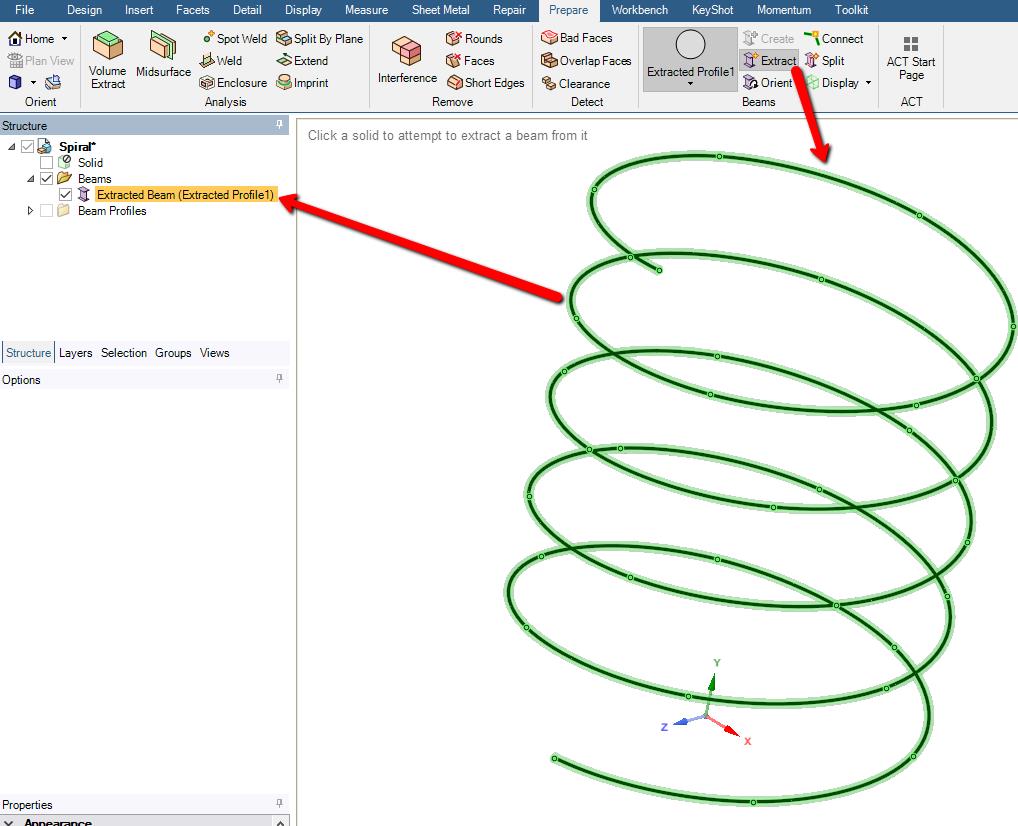

      Hello William,
      Use an Excel spreadsheet to calculate the 3D points on the helix and add two columns for curve number and point number to import a 3D curve into DesignModeler that will be a line body.
      In SpaceClaim, I have created beams from long straight solids by going into the Prepare table and clicking the Extract button and picking a solid. Is that what you tried?  It will work on the thick rods, I don't know if it will work on the spiral.
      Peter
    • Sandeep Medikonda
      William,
      Please see below, may be this method will help you get what you intend to do.

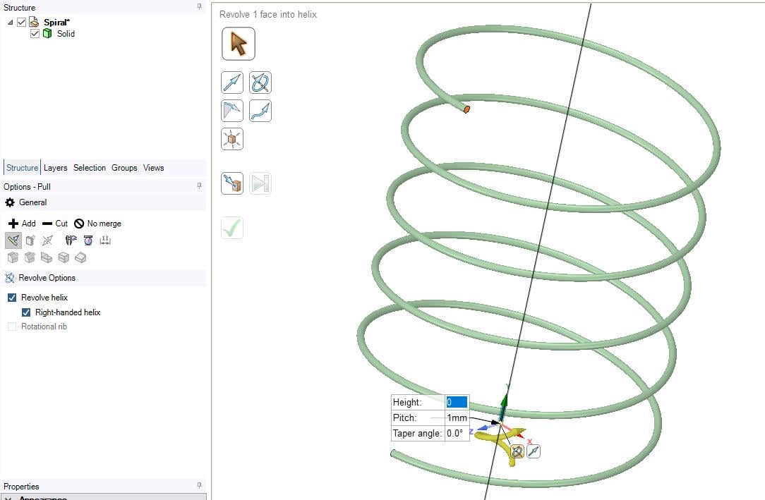

      First, create an Helix-Solid body in SpaceClaim with the options you want (looks like you have this).
      Then use the Extract beams tool to generate the beams:

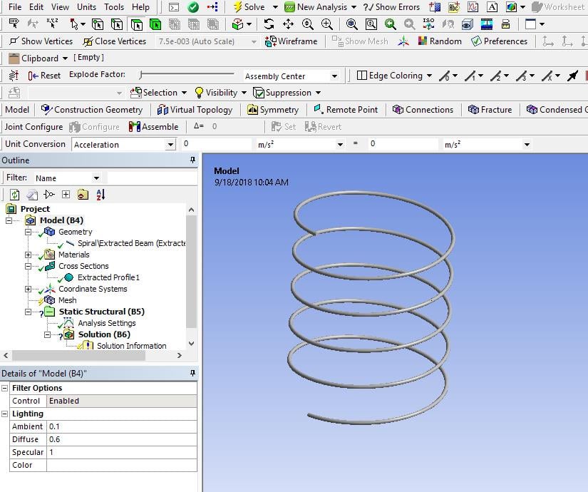

      Lastly, bring this into Mechanical and work with it as needed:
      Sandeep

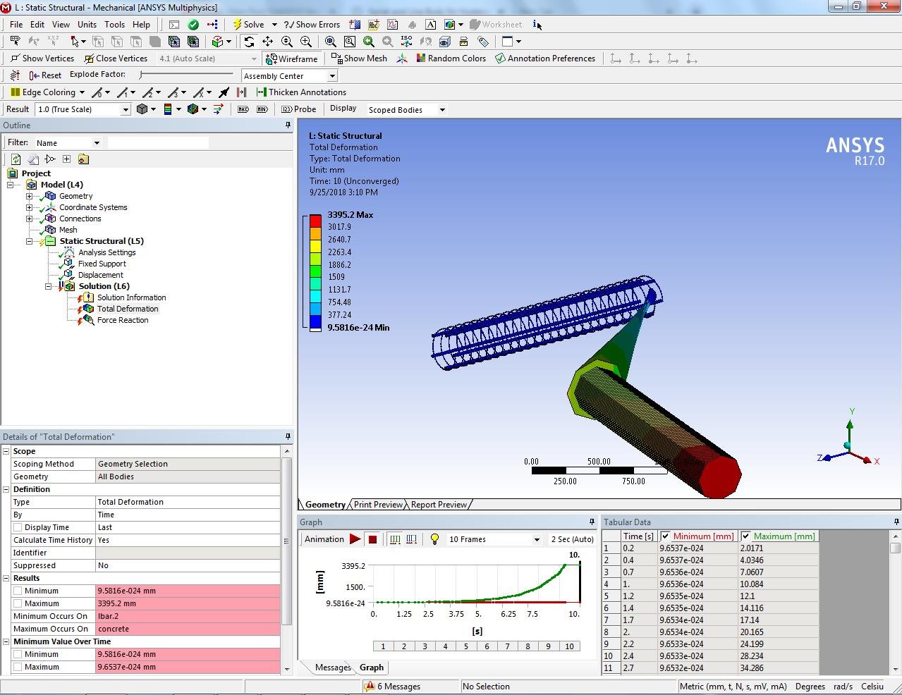

      The next problem I found is my model seems not bond each other. it happens with my spiral column and CFST column under lateral load.

      what are the details you have under contact? It looks like you have a beam to beam contact?
      Beam contact has had significant improvements in 18 and 19? It could just be that, are you able to upgrade?

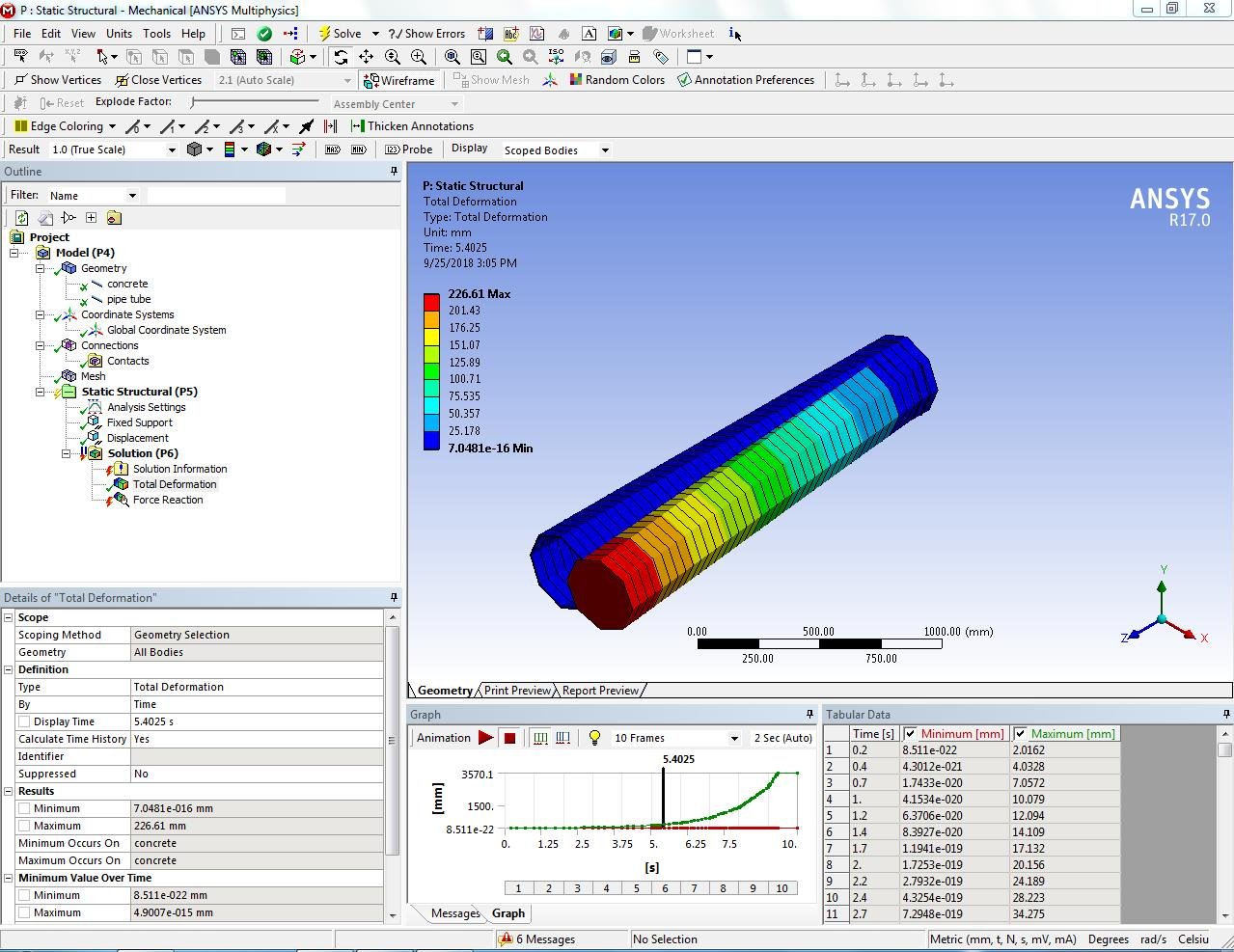

      I want to make these line body parts work together as concrete and reinforcement. but seems it is not work and bonded together.

      This is what I meant:
        If your concrete and reinforcement are touching each other, can you use shared topology?
      Sandeep
      Best Practices to post on the Student Community
    • Ashish Khemka
      Hi William,
      As suggested by Sandeep above, try using shared topology, which may help.
