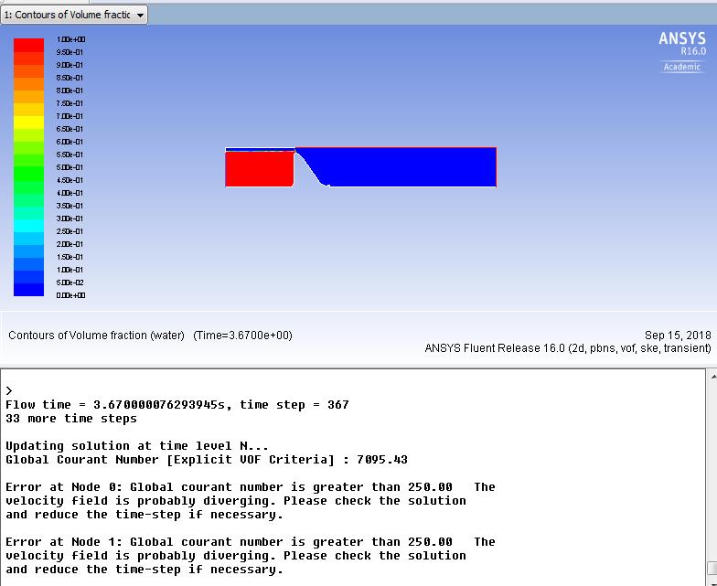

      I am trying to model spillway in 2D. The problem of floating point exception is always troubling me. Can anyone helpme in this regard.

      Please elaborate and provide some more details of your model. Please provide some screenshots as well as explain your boundary conditions. You might also want to take a look at the mesh statistics.
      Floating point error generally occurs when the solver encounters a really small value in the denominator.
      Another questions - does this happen right at the beginning or somewhere in the middle of a simulation?
      Are you running a steady or unsteady problem?
      In short, you might have to explain your problem better so we are able to help you.
      Thank you.

      Boundary conditions: Velocity inlet, pressure outlet, wall
      velocity is 0.892m/s
      the model is scaled to 1:100.
      Yes, the floating point error is in the beginning. min orthogonal quality is 0.245, max. ortho skew is 0.7547, max. aspect ratio is 12.6.

      Hello Prasanna,
      Thanks for the screen shots.
      As I can see the screenshot  and understand that k and epsilon are causing the divergence. I suggest to run with first order upwind scheme with lesser URFs. Can you try reducing the URFs of K & epsilon to 0.6 and run. If you still facing the divergence, you can still reduce to 0.5 or 0.4 and run the case. One more observation is reverse flow at the outlet. May be you can still extend your outlet and continue the run to avoid reverse flow at outlet. Kindly follow these two suggestions and  let me know if you still faces the issue.

      Im sorry to say that,  the problem has not yet resolved with URFs as 0.5 for both k and epsilon and first order upwind scheme
      Can you remesh and force a pave mesh onto the model? Don't use any edge sizing in GAMBIT and when you mesh the face select Pave (it looks to be defaulting to sub map).  You probably also need to refine the mesh over the top of the weir: read up on VOF model and adaption in the documentation.

      hello, after following all your recommendation, im facing the above mentioned problem. Can anyone try to help me in this regard
      I suspect you need to reduce your timestep: the warning (for once) is fairly helpful.  Depending on the flow velocity 0.01s may be too high.

      Hello Prasanna,
      please estimate your time step such that your Courant number does not exceed 1. This will ensure a stable solution. You might want to use the minimum grid size while estimating this time step size to be conservative.
      please let us know what you find,

      Thank you very much for the suggestion. It worked out and the problem is solved
