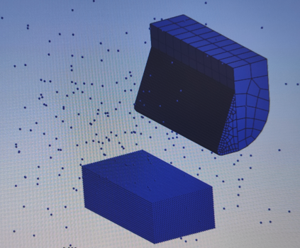

SPH particles scatter when the calculation time changes.
    • javat33489
      Guys, I got a clue to the cause of the particles scattering. I decided to create a new discussion, sorry.
      Look.

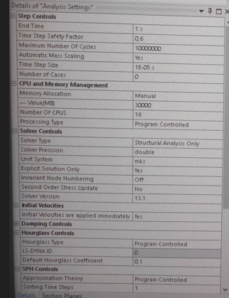

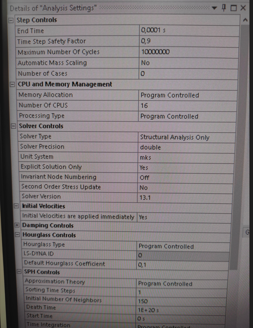

      When I solve the problem in time for 0.0001 sec and turn off mass scaling then the calculation passes. Also, I don't have to add the CONTROL card

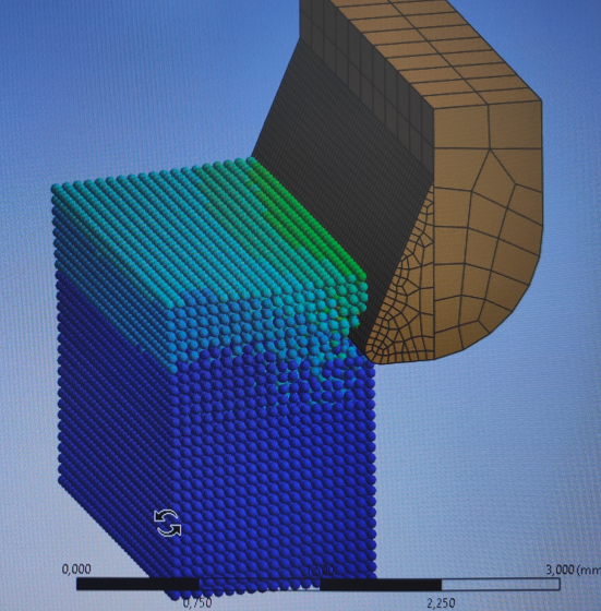

      If I make a task for 1 second and turn on mass scaling and define a timestep then the particles fly apart when the drill and particles come into contact

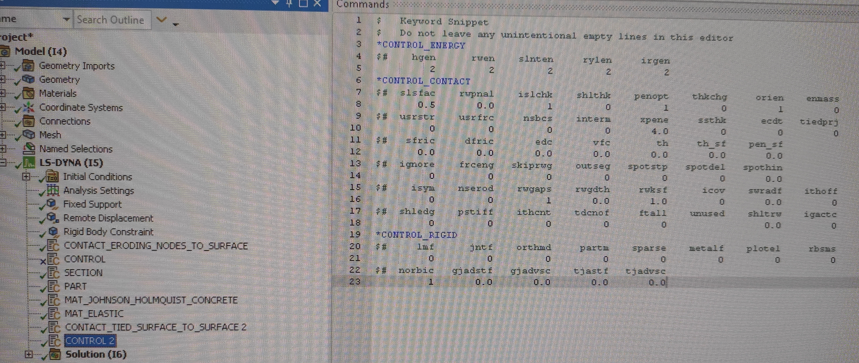

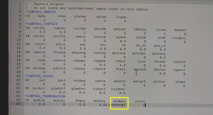

      In addition, I have to connect the CONTROL card with a snippet in order to increase the mass

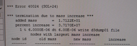

      otherwise I get an error:
      Colleagues, tell me why this is happening?

      • javat33489
        Excuse me sir. This is a relatively new feature. Tell me how to include it in the LS-Dyna WB (ACT)?
