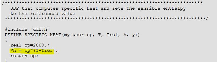

      I have a question about the UDF for the specific heat in FLUENT.
      The unit of the Temperature is Kelvin?
      Moreover the value of Tref should be set in the Materials Panel?
      I wrote this UDF for calculating the specific heat ( in J/kg.K):
      #include "udf.h"
      DEFINE_SPECIFIC_HEAT(my_user_cp, T, Tref, h, yi)
          real cp;
          cp = 5.661*T + 551,21;
          *h = cp*(T-Tref);
          return cp;
      Maxime
    • DrAmine
      Yes it is in Kelvin.  Yes Tref is set in the material panel.
      For a simple formulation that you have it is enough to use polynomial function.
