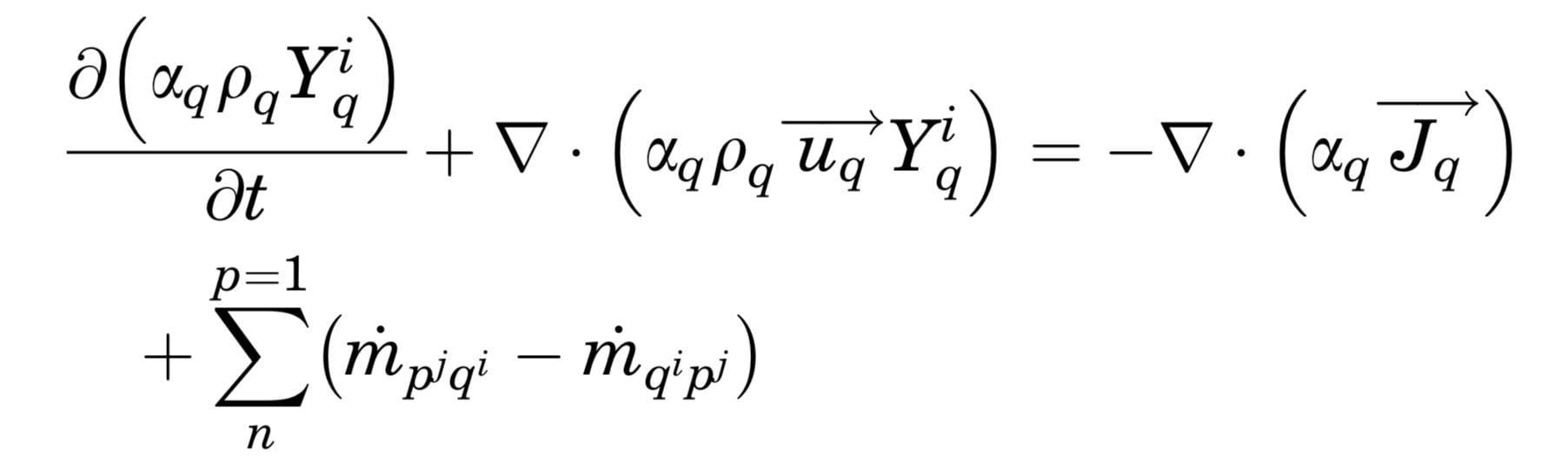

      I am modeling a species mass transfer model, in which I want to transfer a species from one phase to another phase. I am trying to express this process with the last term of the equation given below. [ m_dot(p_j,q_i) = mass transfer of 'species j from p phase' to 'species i of q phase' ]
      Can anyone please help me with a very basic example of which UDF macro to use and how may I assign the phases and the species?

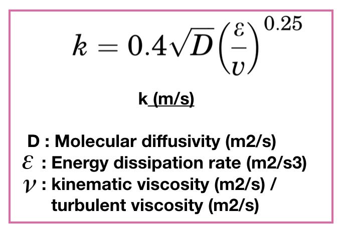

      Okay but can you just help me, in including a rate expression in my udf , the rate expression is as giwen below:
      I know the terms of this expression as: C_D(c,t) (turb. kinetic energy dissipation rate) , C_MU_T(c,t) (turbulent viscosity) , DEFINE_DIFFUSIVITY ( D, c, t, i)
      but how to include these in the reaction rate?
      *rr_t = (0.4*(sqrt(D))*(C_D(c,t) / C_MU_T(c,t)).^0.25 )*((D*delCo2*C_UDMI(c,t,1) )/ C_VOLUME(c,t));
      Am I right? or do I need to do anything else as well?
