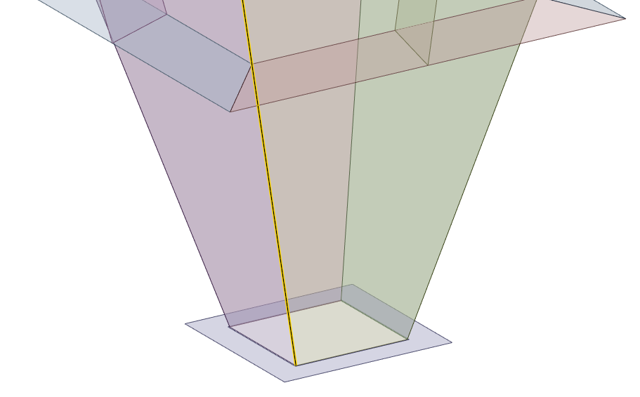

How can I create a fillet using the pull tool for a structure that was created as a step file with surfaces? It does not seem to work for shell structures?
October 18, 2021 at 4:47 pmDoodlerD
SubscriberI figured it out. The step file should have surfaces of the entire cross section created through a loft and not a patch. Alternatively, surfaces need to merged to get the pull tool to work.
