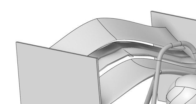

When we generate more complex geometries in Inventor using the loft function (which connects two sketches following a defined curve), some parts of the component—or sometimes the entire component—are lost after importing the geometry into SpaceClaim in STEP format.
The first picture shows the file in Inventor, and the second shows it in SpaceClaim. As you can see, the rear wing presents problems, and sometimes the geometry even disappears completely.
Can someone tell me how to fix the problem?

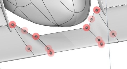

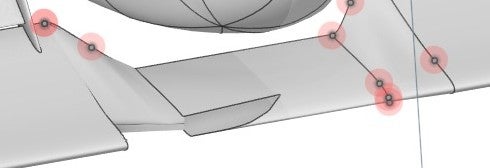

SubscriberThank you for the answer. We've just tried with the same CAD, just by loading the '.x_t' file into Spaceclaim some parts are corrupted as we've already seen in previous images. We've tried to repair these with split edges function and also with inexact edges, some parts are correctly repaired, other instead are even worse. Another issue that we have, that may be correlated to this problem, is that when we try to create the enclosure some parts are excluded.
And also, when we use the split edges tool for repairing sometimes the geometry changes as shown in the pictures.

SubscriberI have ANSYS 2023 R1 available to test your Inventor file if you would like to share the files. I will open your file in SpaceClaim 2023 R1 and check the results. If it comes out well, I can send the file back to you so you can open it in SpaceClaim 2025. Export an ACIS .SAT file from Inventor. If you are able to select the version of ACIS during export, select Version 7. Put the .SAT file as well as the original Inventor file into a folder and create a .zip file to compress the folder. Upload the .zip file to a file sharing site such as Google Drive and set the Sharing so that Anyone with the link can download it and put the link in your reply.
Note that when you are repairing using Split Edges, you can exclude the points that result in a bad outcome.Â
