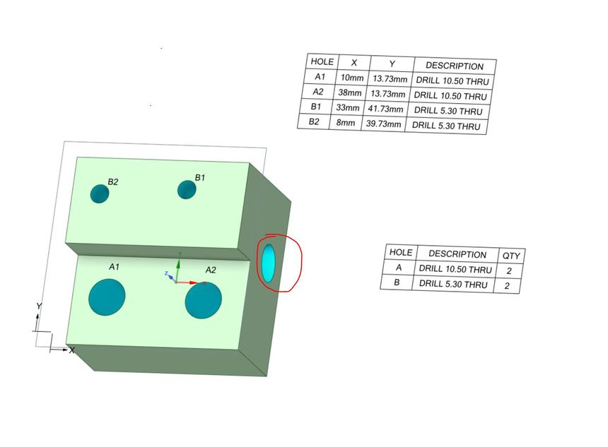

      Hi Support,   Hole tables require X and Y positions but hole charts do not.   Is it possible to produce a hole chart for a 3D model?   In the example below we can see the red circled hole. It doesn't require an X and Y position to be on the hole chart but still it doesn't appear.

      I understand that the hole table displays the holes only on the selected plane.
      That could be the reason it is not showing the hole on a perpendicular plane.
      You can create a new table and select the other plane to list the hole.
    • tim.dukes
      Hi Subashni
      Thank you for the reply. I will put it through as enhancement as this would be a useful feature for a hole chart to display all holes on a model.
      This would save you having lots of hole charts on one drawing when not necessary.
