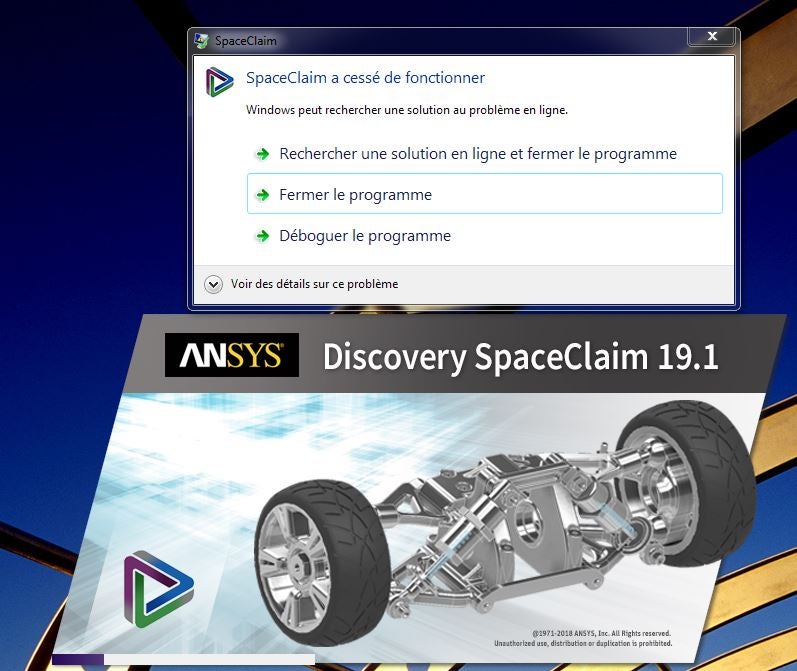

  Spaceclaim has stopped working I have a perpetual license with an up-to-date subscription. Windows 7 pro x64, 16Gb of Ram, GeForce GTX 750Ti, Core i5 3.30Ghz impossible to launch "discovery spaceclaim", after the start of program, one window appears for indicate SpaceClaim has stopped working. i have tested the answer here, but not working again. Discovery Live 19.0 doesn't work and the error is SpaceClaim See the détails of problem: Signature du problème : Nom d’événement de problème:   CLR20r3 Signature du problème 01:   SpaceClaim.exe Signature du problème 02:   2018.1.36864.37377 Signature du problème 03:   5ad788c3 Signature du problème 04:   System Signature du problème 05:   4.7.3130.0 Signature du problème 06:   5b176097 Signature du problème 07:   209a Signature du problème 08:   158 Signature du problème 09:   System.AggregateException Version du système:   6.1.7601.2.1.0.256.48 Identificateur de paramètres régionaux:   1036 Information supplémentaire n° 1:   d32b Information supplémentaire n° 2:   d32ba35a401f4351e73ab3f0b491ebf5 Information supplémentaire n° 3:   7790 Information supplémentaire n° 4:   7790f3d76bf988aa93afa6662548e10d -

We see from our database that your license has not been activated yet. I suggest you go through this link  and make changes to your firewall and then try again. -

SubscriberI know for "Discovery Live" but my problem is for SpaceClaim.
with Spaceclaim 2017 no problem but with update for Sc19.1, this version not working, impossible to launch. -

SubscriberThanks for the link.
Firewall configured and now spaceClaim works again.
