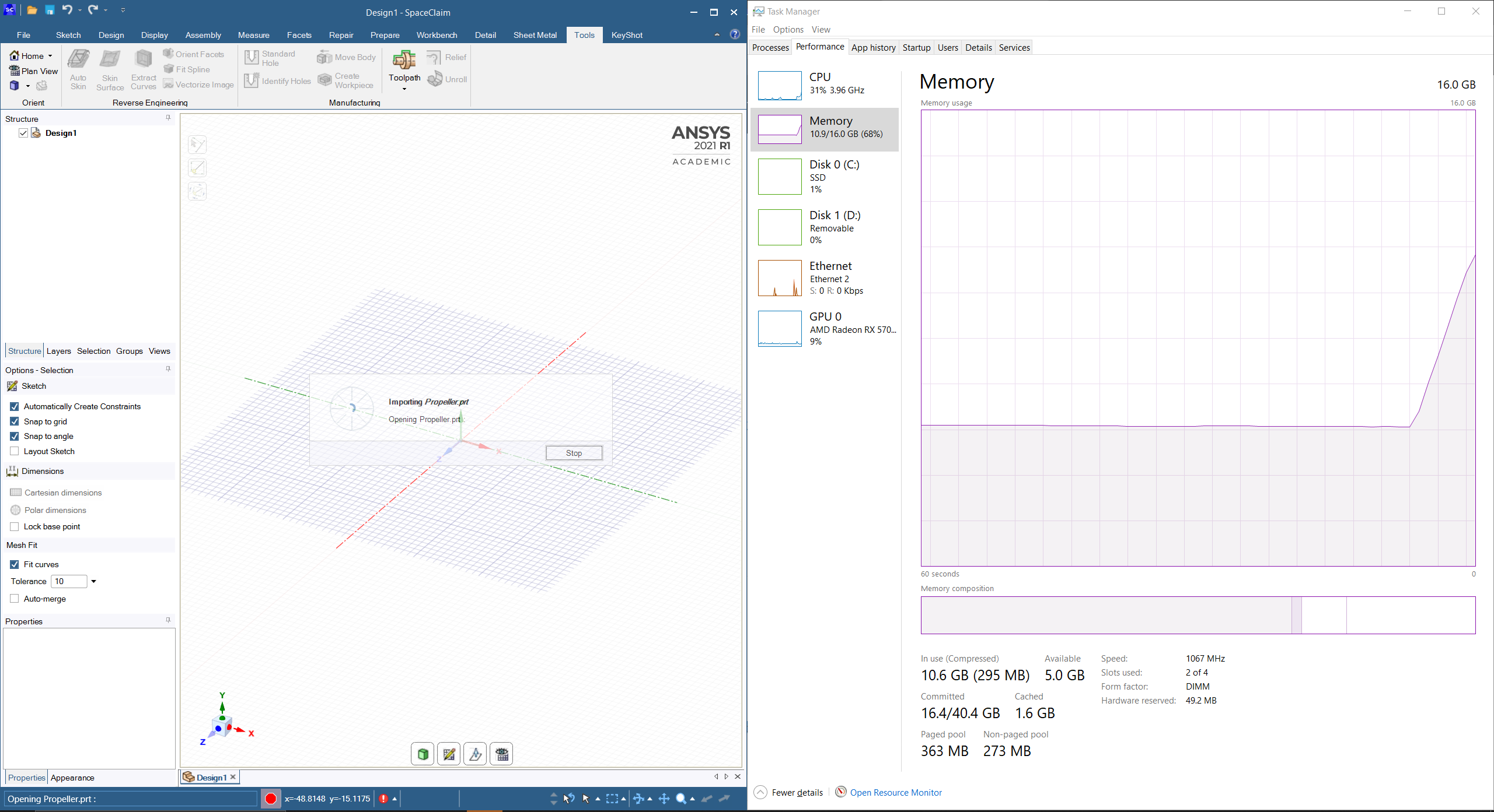

SubscriberAs a student user, I decided to go with @peteroznewman's advice on using SpaceClaim as an intermediary CAD interface.
When I try to open an NX .prt file in SpaceClaim 2021R1, the memory usage goes up linearly and perpetually until a full system crash occurs. I don't have the option of using STEP files instead because NX Student Version cannot export .stp files.
June 16, 2021 at 6:54 pmpeteroznewman
SubscriberWhat version of NX are you using?
Does the Student version of NX export Parasolid?
June 16, 2021 at 7:33 pmasharpe2967
SubscriberIts Student Edition 1953 and I can't find anything that tells me if it's from the standard product line. The only export options are STL, 3MF, IFC, OBJ, and ACIS.
June 16, 2021 at 7:35 pmasharpe2967
SubscriberIt's Student Edition 1953 and I can't find anything that tells me if it's from the standard product line. The only export options are STL, 3MF, IFC, OBJ, and ACIS.
June 16, 2021 at 9:23 pmpeteroznewman
SubscriberOkay, well at least ACIS is a useful neutral file for exporting solid models. I'm surprised Parasolid isn't in the list as my understanding was that was the kernel inside the NX software.
June 16, 2021 at 9:59 pmasharpe2967
SubscriberAnd as I now make the attempt to export as ACIS, I'm told there's no license for it.
June 17, 2021 at 12:27 ampeteroznewman
SubscriberOh well, it seems like both of the free ANSYS and the free NX software are removing the ability to export much of anything useful outside of their platforms.
If you want to put the NX .prt file inside a .rar file format and attach it to your reply, maybe someone has a full version of NX and can export a Parasolid for you.
Also put the .STL file in a .rar file and attach that too, because SpaceClaim can definitely import that, but there is a tremendous loss if quality in the process.
June 17, 2021 at 3:39 amasharpe2967
SubscriberI'm looking at alternatively using Creo's Student version now, which I'm equally comfortable with. The list of exportable file types there is MUCH longer. Plus, SpaceClaim seems to be playing nicely with creo .prt files
