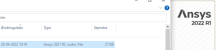

Hi guys.
When i from within SpaceClaim 2022 R1 use Save and Save As the file created changes its file type to a Ansys 2021 R2.scdoc file.Â

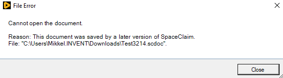

When i open the file from within SpaceClaim its open up just fine. But if i double tap it to open, then it tries to open SpaceClaim 2021 R2. and once it opens it shows this msg:
ÂÂ
Ive tried to press "open with" and locate SpaceClaim 2022 R1. But it doesnt add the /UseLicenseMode=true and to be honest i dont know how to add that.
I have a customer whom always opens his files by double tapping them. And at his pc the last version he used was SpaceClaim 2021 R1. And when he saves his files from 2022. They become 2021 R1.Â
Seems like 2022 doesnt have its own konfiguration and therefore uses the last known version?

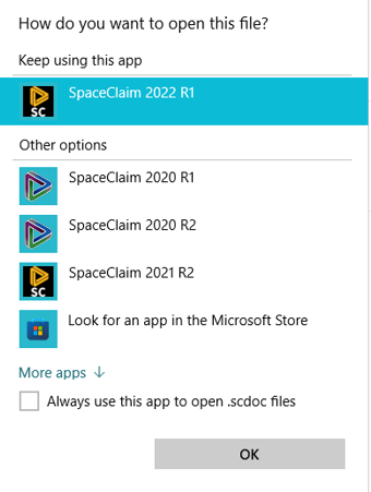

When you press ''open with'' and locate SpaceClaim 2022 R1 there is option below to ''Always use this app to open .scdoc files'', please tick that option while selecting SpaceClaim 2022 R1 and then it will change the File association to 2022 R1.Â
This is something to do with windows registry and may be it did not changed when you installed the 2022 R1 update.

SubscriberDevendra Badgujar I dont have the SpaceClaim 2022 R1 on the page as you showed on the attached picture. For me i have to press "look for more Apps"
I will try and reinstall everything and see if that fixes anything, and then ill get back to you. -

Yes, it is because I have Selected SpaceClaim 2022 R1 and turn that option.Â
When you press look for more apps you will see SpaceClaim 2022 R1, you will have to select that and turn on the ''Always use this app to open .scdoc files'' and then the file association will change to 2022 R1 and files will be opened in SpaceClaim 2022 R1.

SubscriberDevendra Badgujar SpaceClaim 2022 R1 simply doesnt show up. But after a quick reinstall it showed up, and now i have the option to choose SpaceClaim 2022 R1. Must have been a corrupt installation the first time.
